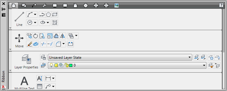

change length of layer control dropdown in toolbar

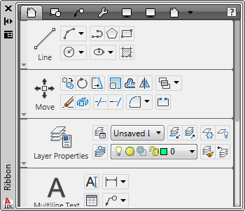

You can also "undock" the Ribbon Tool Palette (you DID know it's a Tool Palette, right?), and either widen the floating Palette, or Anchor (Left, or Right), and widen there as well.
Before:
After:
HTH

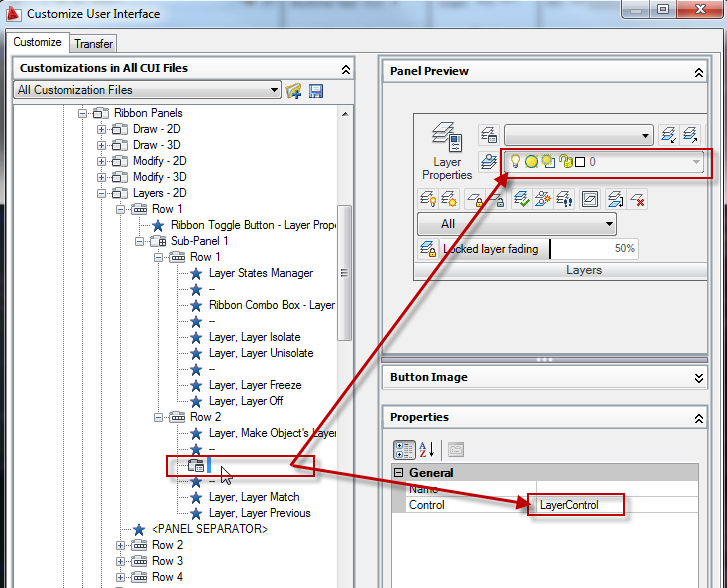

I was able to modify the ribbon, as I think nestly did. BTW, at the very top of his image is the modified drop down.
designerstuart, I'm using 2011 & 2012, but it should be the same for 2009.
First of all, you have to enable the QAT for each workspace that you want it to be displayed (I'm not sure if it's turned on in the Classic workspace by default) . Also you can have multiple QAT's with different tools, but only one can be active for each workspace.
In the left panel of the CUI, pick the workspace, then click the "Customize" button in the right panel, then go back to the left panel and there should be a checkbox next to the QAT. As soon as you check that and click "Done" then "Apply", the QAT should show up for that workspace.
Go back to the left panel, expand the Ribbon > Panels > Home - Layers > Row 3 > Layer List Combo Box. Right click on that and copy it, paste it into your QAT then you should see what's in my 1st screenshot, which allows you to enter a minimum and maximum length

Demo -->

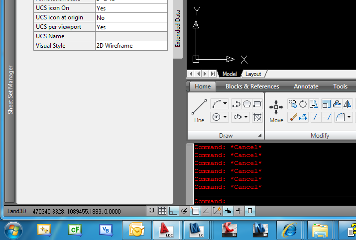

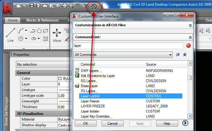

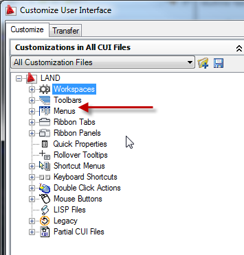

Second, there is no 'Layer List/dropdown' in 2009, there is only the 'Layer Control'. These pics *should* help to clarify:
Land Desktop 2009 CUI Editor:
Land Desktop 2009, Layers Ribbon Panel:

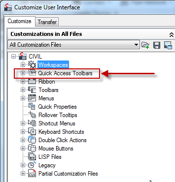

Civil 3D 2011 CUI(x) Editor:
^^ Note the missing 'Quick Access Toolbars' node in the 2009 CUI Editor.
I see... It looks like they re-used the existing Toolbar Layer control for the first generation Ribbon, but they created a different layer control for the Ribbon in later releases.
As for the missing QAT, apparently there was a bug in 2009 that can cause it not to appear in CUI, but it can apparently be restored without too much effort.
i've been looking at this solution - i like it. must say i didn't know how the ribbon worked, but reckon i could make a little tool palette just for this dropdown, and stick it up over file - edit - etc (i tend to work with commands - very few buttons / toolbars required) that would work for me. will look into this.

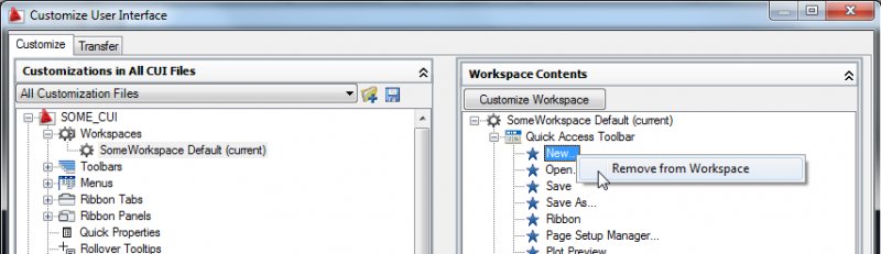

but i'm still puzzled by not being able to remove things from the QAT - could this be related to its reduced functionality? it's as if they've accidentally forgotten to put an entry for it in the menu....
Again, the functionality of the QAT is very different from 2009->2011.
... In 2009, the QAT is solely a sub-component of the Workspace Item. To customize, Open the CUI Editor, and in the left pane select the desired workspace. In the right pane expand the QAT node, and Right Click the undesired items (one at a time), and select Remove.
Example:
Surprisingly, most are not aware that the Ribbon is in fact a Tool Palette, and by definition, inherits similar functionality. I blame Autodesk for doing a poor job selling others on the Ribbon interface - as it turns out they were too busy forcing down everyone's throat, instead of simply demonstrating it's flexibility & potential... I digress :sigh:
In addition to being 'Docked' (Top, Left, Right), Floating, and Anchored (Left/Right), one can also 'Dock' the Ribbon Tool Palette along the Bottom:
... Again, this will simply suffer the same Panel width issue this thread is attempting to combat.
