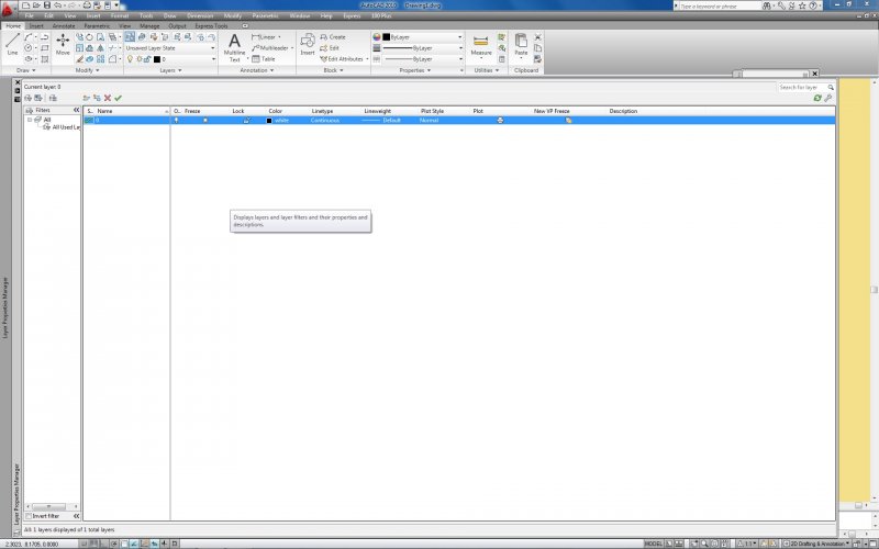

Click on the icon on the left that looks looks a stack of papers. That is the Layers Property, you will be able to add layers when that is open.
is it possible to extend the dropdown box so i can view whole layer names?
I think he want's to open the Layer Property Manager Window.
thanks ollie, but no. i want to see more of the names of the layers in this dropdown.
I think designerstuart wants the Ribbon's Layer drop down menu to be extended in width, so that the entire layer name is visible...
Survey says!?
When the Layers Property Window is open as in post #3 the columns can be expanded, as in Excel to show the full name.
Click in the header bar between two names, until the courser turns into the icon with two parell lines and arrows pointing to the left and right.

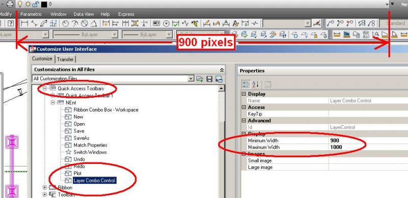

Also, if you put the Layers Combo from the Ribbon in the QAT toolbar, it can be as wide as the unused space in the AutoCAD titlebar.
I dunno... ManuSoft QuikPik seems to have figured how to do it (see feature #14)
[ATTACH]29117[/ATTACH]
Confirmed.

so i have been learning all about QAT, have managed to add some regular commands to it but cannot find it, or a layer combo control like you have, in my CUI. (incidentally cannot work out how to remove items from it no they are added, as simple drag or right-click not working)
any idea why i can use the QAT but not find it in the CUI? your demo is on 2009 too, right? i don't use the ribbon, but it's not shown in your shot either..... dunno!
also DNK you said confirmed - have you actually managed to do this? cos i notice nobody did a screen shot!
