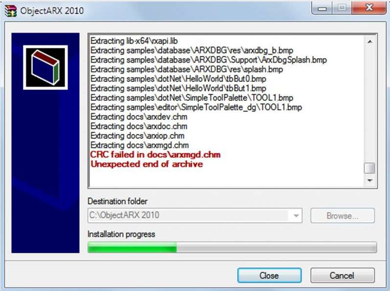

Tharwat Posted July 30, 2011 Share Posted July 30, 2011 hello everyone . I have been trying to download the ObjectARX from Autodesk for a long time now and without a result , actually the download finishes but when start installing the downloads it gives me the message ( I have attatched image ) Many thanks Quote Link to comment Share on other sites More sharing options...
Jack_O'neill Posted July 31, 2011 Share Posted July 31, 2011 A google search of that file name brings up a couple hundred results, and just quickly looking down through them, I'd say you're not alone. Most of them are complaints about it not working, or not working with 2011, or various other problems. Sounds to me like the file may be corrupted and Autodesk hasn't gotten round to replacing it with a good one yet. Quote Link to comment Share on other sites More sharing options...
Tharwat Posted July 31, 2011 Author Share Posted July 31, 2011 Thanks jack . I did google for many times and downloaded two different versions for 2009 win 7 OS 62 and Cad 2010 Win 7 OS 32 and both of them are the same bad result . That's really disappointing from Autodesk when they do not care about their products' users . Regards. Quote Link to comment Share on other sites More sharing options...

BlackBox Posted July 31, 2011 Share Posted July 31, 2011 According to the pic, the installation is incomplete, not the download... Hense my question. Quote Link to comment Share on other sites More sharing options...

Jeff H Posted August 1, 2011 Share Posted August 1, 2011 Have tried after downloading the file and before unzipping or doing anything with the file right click and select properties and click the unblock button. Quote Link to comment Share on other sites More sharing options...

Tharwat Posted August 2, 2011 Author Share Posted August 2, 2011 Have tried after downloading the file and before unzipping or doing anything with the file right click and select properties and click the unblock button. That was great Jeff H . I did try it and finally succeed the process . thank you so much Jeff H . And I found out that I have to download the MSI manually and now the ARX is fully installed . Highly appreciated . Tharwat Quote Link to comment Share on other sites More sharing options...
