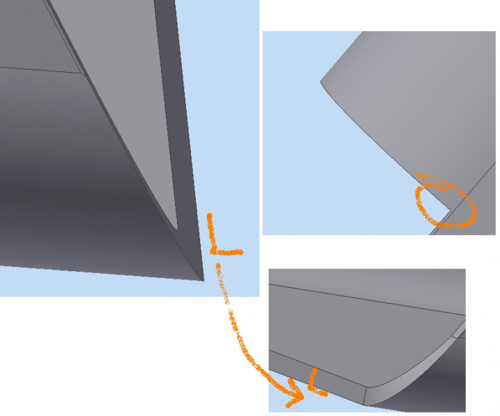

If you zoom in notice that the fillet doesn't end at the flange but goes all the way down the part - I don't think this is what you intended for a sheet metal part.
On the fold at the base the edges must be perpendicular to the flat (hard to see from my correction to your part, but hollar back if you don't see (or understandy why) the difference.

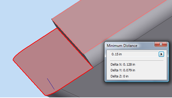

You have a distance of .15 here between these faces but then you add a .152 fillet. Obviously that won't work unless you cut a notch at the ends of the flange.
