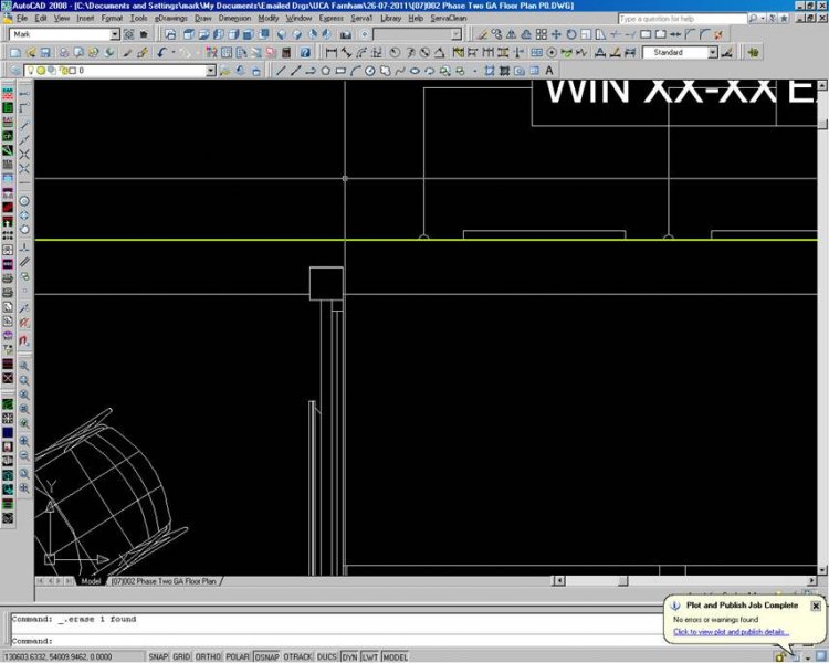

ServaCleanCAD Posted July 27, 2011 Posted July 27, 2011 Hi all, I've received a drawing from a customer, which is a room layout in 2D. There are loads of lines which are invisible, but you can see they are there by selecting them. I've moved all lines to a visible layer, they are all the same colour, thickness, linetype, etc (I've checked this by drawing a new line, and matching properties with it), but the lines refuse to remain visible. Has anyone found this before, and know of the reason for the invisible lines? Thank you Quote

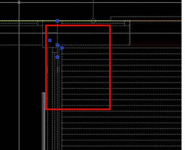

nestly Posted July 27, 2011 Posted July 27, 2011 Could they be behind a wipeout or solid hatch. Quote
SLW210 Posted July 27, 2011 Posted July 27, 2011 You could post an image or everyone could continue guessing. Did you check layer transparency? Quote
ServaCleanCAD Posted July 27, 2011 Author Posted July 27, 2011 SLW210 - do you need a beer? This is the second time you've replied to me in a less-than-friendly way. Remember, this is the "AutoCAD Beginner's" forum, hence I'm new to this. Anyway, how do I post a picture of an invisible line? The first image would show a black screen, the second would show a selected straight line?!? I'm sure you don't need to be Stephen Hawking to guess what it would look like.... Anyway, I've found a wipeout linetype that I can't purge. There are also a load of blocks which I can't purge. I'm sure this is something to do with XREF's, which I don't understand at all, they seem like a waste of time to me... Please help! (not with "everyone can continue guessing" remarks please) Quote
ServaCleanCAD Posted July 27, 2011 Author Posted July 27, 2011 Hi Nestly, I can't see a way of attaching a DWG - only a link or image. The drawing is 5Mb anyway, and I've discovered that it has been created using something other than AutoCAD, as it said as I opened the drawing in AutoCAD. There are approx 40 blocks which I can't select or purge (I've tried all I know, like qselect to pick them). There is a wipeout linetype which I also can't purge, as it's "used in the drawing". I'm resorting to plotting the drawing as a PDF, and converting it back to DWG. Messy, but works. Quote
Arizona Posted July 27, 2011 Posted July 27, 2011 Dude, XRef's are simply another drwaing shown in the background. A Fabulous tool. Did you check layer transparency? When you do select one of the ******s, in the properties box: - what layer is it on? - what color is it? - what linetype is it? - what are it's Z values? What happens if you put it on a different layer? Also - You could be in Perspective View. Sometimes that makes a mess. Try typing PLAN, then hit enter twice. There are may things that could do this. To attach: Click REPLY (not the quick reply but the full one) Click MANAGE ATTACHMANTS Quote

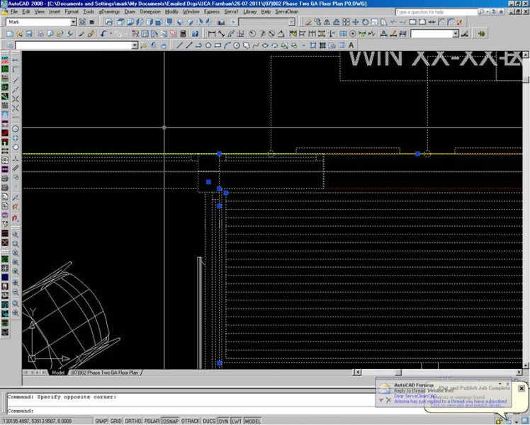

ServaCleanCAD Posted July 27, 2011 Author Posted July 27, 2011 Ok, you talked me into posting images.... There's a "before select" and "after select" Quote
ServaCleanCAD Posted July 27, 2011 Author Posted July 27, 2011 Of course, the images are the wrong way round - the before select is the lower image, the after select is the upper one. Quote

nestly Posted July 27, 2011 Posted July 27, 2011 Can you use a crossing window to select a small portion of the drawing then use WBLOCK to export the selected items to a new drawing file. That should be small enough to post as an attachment, while still including a sample of both the visible and invisible obects. Quote
qball Posted July 27, 2011 Posted July 27, 2011 are the lines Black colour, or very close to it? maybe Block out a small portion of the drawing and upload it here using Go Advanced, Manage attachments Quote
Organic Posted July 28, 2011 Posted July 28, 2011 It looks like a wipeout or solid hatch as already suggested to me. You really do need to upload the file so we can try it out. I don't think SLW210 was being unfriendly either in my opinion. Quote

Tyke Posted July 28, 2011 Posted July 28, 2011 Mark, we get drawings from a non AutoCAD source and can also not see some of the lines, because of their colour and the background colour of the graphics area. We just changed the graphics area background colour to a mid grey and all the lines were then visible. We are not allowed to change the colours of the lines as it cocks up their system when they read the data back in. Quote
