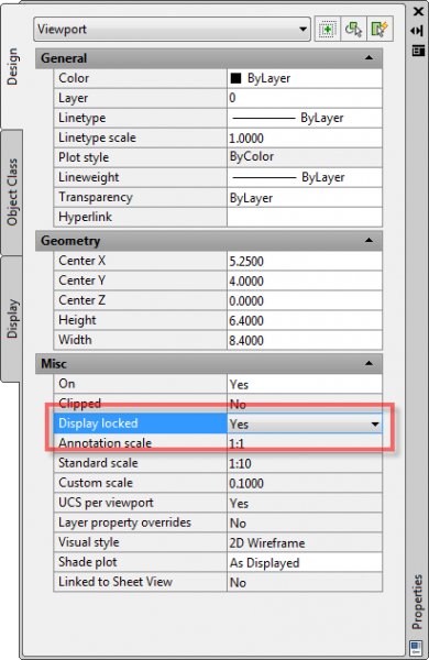

Murph_map Posted July 27, 2011 Share Posted July 27, 2011 Another tip that may help you is to lock the viewport after you set the scale, that way when you zoom in model space of that viewport it zooms the paper space and not the model. To lock the viewport select it (PaperSpace) and in the property palette, select Display Lock and change it to yes. Quote Link to comment Share on other sites More sharing options...
GuyWalker Posted July 28, 2011 Author Share Posted July 28, 2011 @murph_map. if id known that 3 months ago i would have saved 4-5 days in time i rekon haha thanks heaps!! Quote Link to comment Share on other sites More sharing options...
