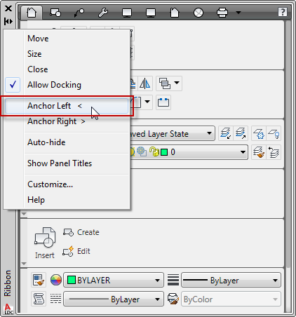

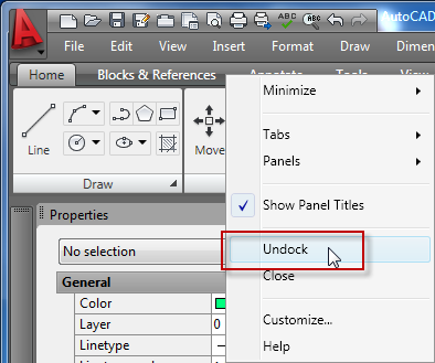

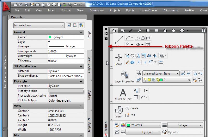

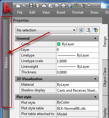

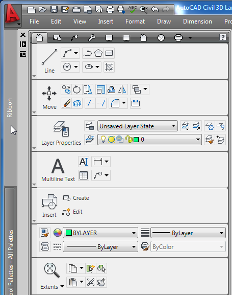

BlackBox Posted July 27, 2011 Share Posted July 27, 2011 Guys, you're killing me here - The ribbon IS a Palette!?! [ThisIsYourBrainOnDrugsToneOfVoice] This is your Ribbon Palette "Docked", now Right Click, and select "Undock": This is your Ribbon Palette "Undocked": Right Click the Ribbon Palette's title bar (or select the options button), and select Anchor [Left/Right]: This is your Ribbon Palette Anchored Left: This is your Ribbon Palette Anchored Left, Expanded: Edit: Forgot to mention, your tabs are the icons running along the top of the Ribbon Palette. ... Any questions? [/ThisIsYourBrainOnDrugsToneOfVoice] Quote Link to comment Share on other sites More sharing options...

Jack_O'neill Posted July 27, 2011 Share Posted July 27, 2011 He he...I did not realize it was a palette. Everybody talks about palettes and the ribbon separately, and I had not investigated far enough. Thanks Renderman...I'll dig deeper. I simply have not taken time to explore this tool fully. Quote Link to comment Share on other sites More sharing options...

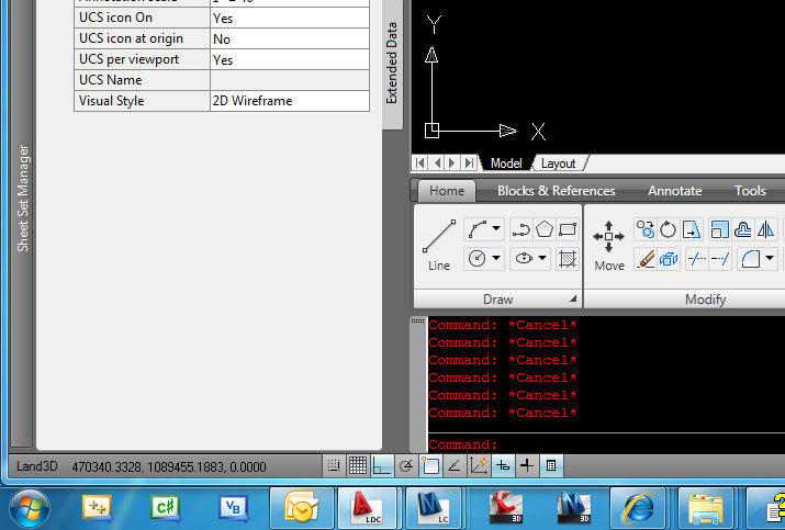

BlackBox Posted July 27, 2011 Share Posted July 27, 2011 Oh, I also forgot to mention that the Ribbon (Palette) can also be Docked at the bottom... just like the Default location for the Command Line. With the Ribbon (Palette) Undocked, and Unanchored, drag the Ribbon (Palette) to the bottom, until you see it "Dock". Screeny: The ridiculous configuration shown above is for demonstration purposes only... I cannot imagine anyone actually using this configuration for production. LoL Quote Link to comment Share on other sites More sharing options...
