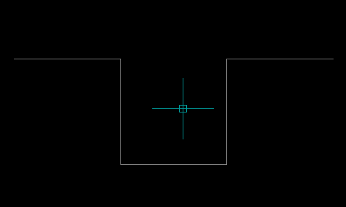

madmonocle Posted October 11, 2012 Posted October 11, 2012 This is a really useful script, but is there any way to make it automatically run when you insert the block in the first place? For example, I use a lisp script to insert certain blocks: (defun c:valve (/ pt) (while (setq pt (getpoint "\nPick Insertion point.")) ; Choose insertion point (command "-insert" "k:/valve" "_non" pt "" "" pause) ; Insert block ) (princ) ) Right now I type in "valve" and place the block on an existing line. Next, I type ABBE and click on the valve, which trims the lines. Is it possible to automatically trim the lines between the block as soon as I place it? Quote
Lee Mac Posted October 11, 2012 Posted October 11, 2012 (edited) This is a really useful script, but is there any way to make it automatically run when you insert the block in the first place? Assuming that you are referring to my Automatic Block Break program and not the other program posted in this thread, you can call the LM:AutoBlockBreak subfunction contained in my program from your code, for example: (defun c:valve ( / el ) (setq el (entlast)) (while (vl-cmdf "_.-insert" "k:/valve" "_S" 1.0 "_R" 0.0 "\\") (if (not (eq el (setq el (entlast)))) (LM:AutoBlockBreak el t) ) ) (princ) ) Of course, you will need to ensure that my program is loaded in the drawing session before calling the function. Demo: PS: Please edit your post and enclose your code with code tags: [highlight][noparse] [/noparse][/highlight] Your code here [highlight][noparse] [/noparse][/highlight] Edited October 11, 2012 by Lee Mac Quote
Lee Mac Posted October 20, 2012 Posted October 20, 2012 ...is there any way to make it automatically run when you insert the block in the first place? Did the above solution work for you, madmonocle? Or did I waste the time & effort I spent responding to your question? Quote
madmonocle Posted October 21, 2012 Posted October 21, 2012 It worked brilliantly, thanks for the help! Quote
