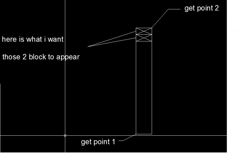

CadFrank Posted July 22, 2011 Share Posted July 22, 2011 Hi to all, I am new at lisp and i would like to kno how create box and inserte a block in it. for exemple a 2 x 4 stud and on top or it a of a 2 x 4 Quote Link to comment Share on other sites More sharing options...

CadFrank Posted July 23, 2011 Author Share Posted July 23, 2011 Hi, well this is simple for some people but im new at autolisp. I would need to create a lisp for the image ill be showing you. i can create a lisp to make a box but i can't inserte the block in it. so if some1 can help me figure out the rest i would be gratefull. thank you! Quote Link to comment Share on other sites More sharing options...

CadFrank Posted July 23, 2011 Author Share Posted July 23, 2011 here is the block with demension Quote Link to comment Share on other sites More sharing options...
paulmcz Posted July 23, 2011 Share Posted July 23, 2011 Since nobody knows the dimensions of your block, following code is good for inserting first of your blocks. For the second one, you need to calculate location of the second insertion point. (command "_.insert" "path or block's name" point2 "x-scale" "y-scale" "rotation") If the block is already in the drawing, skip the path Quote Link to comment Share on other sites More sharing options...
paulmcz Posted July 23, 2011 Share Posted July 23, 2011 (edited) OK, the second block will have to have the insertion point = p3 => (setq p3 (polar point2 (* pi 1.5) 38.0)) Edited July 23, 2011 by paulmcz Quote Link to comment Share on other sites More sharing options...
CadFrank Posted July 23, 2011 Author Share Posted July 23, 2011 So lets say this is the code i started [font=Courier New](defun c:BOX ( / pt1 pt2 pt3 pt4 )(setq pt1 (getpoint "Pick first corner: "))(setq pt3 (getcorner pt1 "Pick opposite corner: "))(setq pt2 (list (car pt3) (cadr pt1)))(setq pt4 (list (car pt1) (cadr pt3)))(command "line" pt1 pt2 pt3 pt4 "c" )[/font](command "_.insert" "path or block's name" point2 "x-scale" "y-scale" "rotation")(setq p3 (polar point2 (* pi 1.5) 38.0)))) would this be ok! Quote Link to comment Share on other sites More sharing options...
paulmcz Posted July 23, 2011 Share Posted July 23, 2011 (edited) This would do it, if the block's name is "123", it resides in the drawing and you want to accept x-scale as 1.0, y-scale as 1.0 and rotation as 0.0. (defun c:BOXX (/ osn pt1 pt2 p3) (setq osn (getvar "osmode")) (setvar "osmode" 0) (setq pt1 (getpoint "Pick first corner: ")) (setq pt2 (getcorner pt1 "Pick opposite corner: ")) (command "rectang" pt1 pt2) (command "_.insert" "123" pt2 "" "" "" ) (setq p3 (polar pt2 (* pi 1.5) 38.0)) (command "_.insert" "123" p3 "" "" "") (setvar "osmode" osn) (princ) ) Edited July 28, 2011 by paulmcz Quote Link to comment Share on other sites More sharing options...
