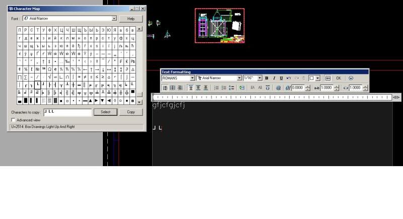

I've been using an mtext symbol as a work around, there may and probably is a better way but heres a screen shot of what i've been using, unfortunately limits your font capabilitys and in my opinion doesnt look the way I'd want but its quicker and easier than anything else I've come across and atleast allows for some standardization.
