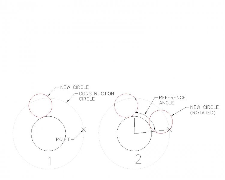

Is there any way to draw a radius tangent to a circle and a point?
given: circle1, point
Draw new circle tangent to circle1 with required radius
Draw a circle w/ radius point @ center of circle 1through point (construction circle)
Rotate reference new circle around center of circle1 from intersection of new circle and construction circle to point.
Trim; erase construction circle
Clear as mud?
How can you have a tangent to a point? :cry:
I can see that Ipseifert is clever enough to do it, but I would need more information :?
By definition a point can't be tangent to a curve so I assumed the OP wanted the curve to pass through the point.
