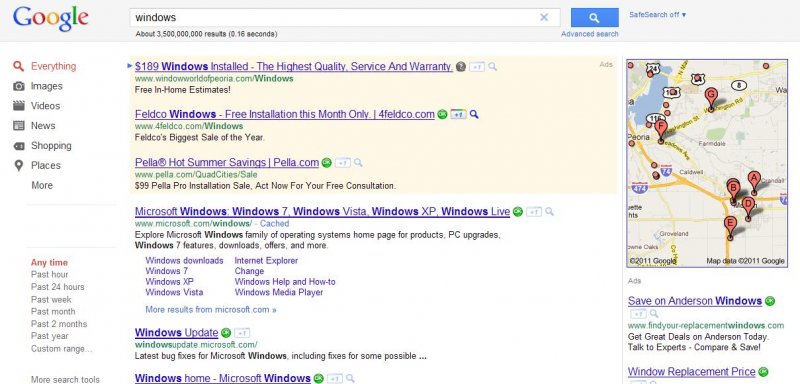

Raudel Solis Posted July 22, 2011 Author Posted July 22, 2011 Quote it don't matter how pretty it is if you can't build it. i made a thread a few months back about the role of an architect. isnt that what architects do? design stuff that cant exist in the real world at the moment iv'e checked out a few books a while back and all i saw in them designs by people with no prior structural back ground. i have a work book "architectural drafting and design" 4th edition, it seem rather useless to me without the 3rd, 2nd and 1st edition but it does come with quite a lot of blue prints. about the window. the dimensions i used will not cause water to drip on the top flat area of the window extrusion. also you may find this funny. Google windows and see the result:lol: Quote
