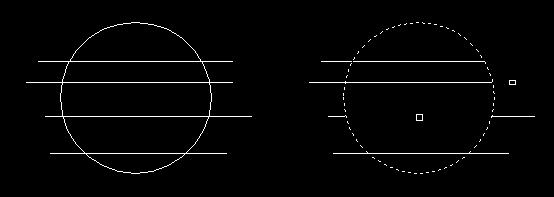

Jack_O'neill Posted July 20, 2011 Posted July 20, 2011 You mean trimming? That's easy. Start the trim command, then pick a line or circle that you want to be a boundary. You can have more than one or simply hit enter to select everything in the drawing. Then pick the objects you want to trim, but pick them on the side you want to cut off. See pictures below: By selecting the circle as the boundry, pick inside the circle and it trims whats inside away. Pick outside the circle it trims that. Nothing to it. (And no, I don't have 2 cursors on the screen, I faked that with a rectangle.) Quote

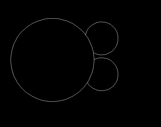

apowersite Posted July 20, 2011 Author Posted July 20, 2011 Hello Renderman, Yes that is the same thing I have in the Autocad 2011 book . You have to know you are dealing with an idiot here. I have been trying for a while and it doesn't work for me. I have a large circle just touching two smaller circles and all I want to leave is the radius between the two small circle. I guess I should use an ARC. but I can't use an arc either. Quote
BlackBox Posted July 20, 2011 Posted July 20, 2011 No need for self-deprecating humor at this time... we'll get to that later, and I'll lead the way! Now that you've provided more information, I can tell you that sometimes AutoCAD has a hard time trimming tangent arcs / circles. I sometimes need to draw a line from the center of one to the center of the other then use the resultant line / polyline to trim. HTH Quote

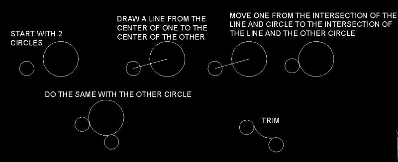

Jack_O'neill Posted July 21, 2011 Posted July 21, 2011 Sometimes if you've drawn your circles using the tangent osnap, they don't always quite touch. Autocad will display a decimal dimension to 8 decimal places but actually computes it to 16 places if I remember correctly. If they miss touching or intersecting each other by somewhere in that minute amount, the circles won't trim each other. If you're working in 3 or 4 decimal places, the rounding error could throw it off that much. The diagram below shows a way to make sure they touch. I've moved the circles far enough apart to make it easy to see. If you move the circles along the line as described, the intersections will overlap and allow the circles to trim. Just be sure to move the third circle towards the first two or you'll only separate the first two again and be back where you started. Quote

apowersite Posted July 24, 2011 Author Posted July 24, 2011 Thanks Jack. My problem was having the two smaller circles and bringing the larger circle to touch the two smaller ones and then trim the same way you show in your drawing. I managed to get it once and with luck I will be able to do it again. Now I am trying to learn layering. very confusing. a lot of the drawings need broken lines and I just can't do it yet. Quote
