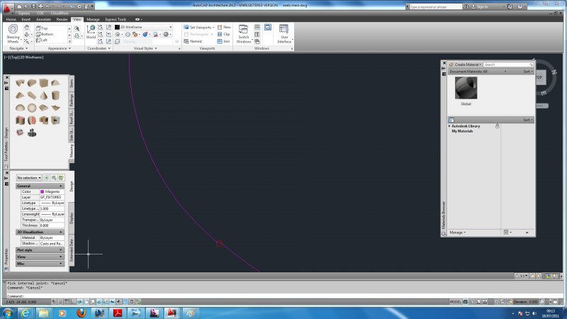

Jimidy Posted July 18, 2011 Posted July 18, 2011 Hi i'm new on the forums so thought i'd start with saying Hi all This may be a very basic problem but it is something i've never come across before, I have been trying to work on a drawing that someone originally created in the 2005 version. for some reason when I try and fillet a line and an arc the end result misses and the lines are no longer joining (massive issue when wanting to hatch or create regions for 3D modelling etc.) please see attached can anyone enlighten me on why this is happening? I've Audited, purged, resaved it to 2010 format and it still seems broke. Is there a variable somewhere the original user may have changed? *The attached drawings are being worked on in meters I'm trying to fillet a 0.02 radius to what i've shown and as you can see the end result is not as expected. the gap is only very small and unnoticable when zoomed out but it is there and causing greif lol Please help - thanks guys Quote

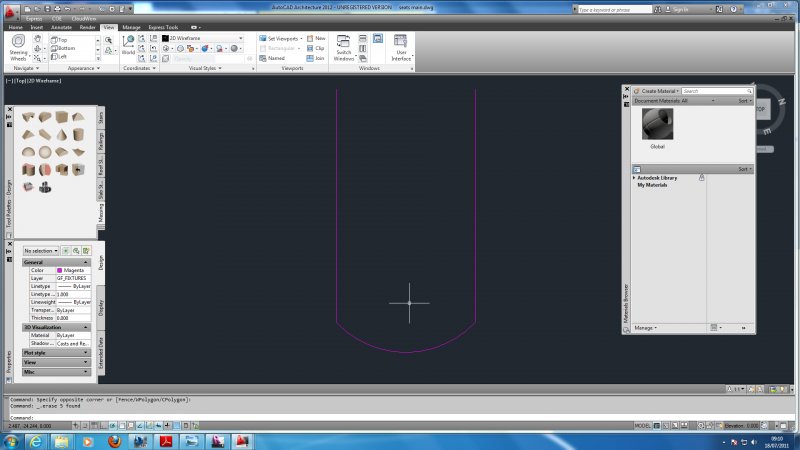

Jimidy Posted July 18, 2011 Author Posted July 18, 2011 kk i've attached the file i'm working from, I probs shouldn't have said hatching was an issue, I'm trying to create these seats as a 3D model the fillet problem is happening on the seat arms which i'm trying to make a smoother profile of rather than having the sharp edge they would have if i just profiled as they are. i know i could do the fillet after i've created the solid but this problem seems to be occuring regularly so i want to nip it in the bud now. i need to find out why it is happening really as it's slowing my workflow quite alot Thanks again seats.dwg Quote

Jimidy Posted July 18, 2011 Author Posted July 18, 2011 It's right there in the pics???? The shape before the fillet (the bottom one) and the shape after the fillet (the top one) dunno why they shown in that order as i uploaded the other way around. there is a little red circle around the gap that occured after the fillet command was used. Fillet is what i need to use as i want a consistent smooth profile from the straight edge to the arc, i will then want to use this shape as a path for a profile. (I've done this kind of thing many times before, but for some reason it's not working how it normally does, tried the usual copying to another file audit purge etc. and nothing is working) I need to find out as the post topic suggests why this is happening. try doing what i've done and you'll get what i mean, i need to stop gaps occuring when i fillet a line and an arc. Please help Quote

Jimidy Posted July 18, 2011 Author Posted July 18, 2011 KK it don't really matter, I was hoping that someone knew exactly what i was talking about and was going to say, just do this and problem solved. I stress again the problem was filleting between a line and an arc, you shouldn't really need to see a file to test that, just do it in whatever drawing you have open lol. Turns out it was an issue with receiving the drawing from the 2005 autocad. I redrew it from scratch in 2012 and the problem has gone, maybe it was just a random error on that survey file i was working from? but I've dodged it now anyway. Quote
dbroada Posted July 18, 2011 Posted July 18, 2011 I agree that the images don't help but I can find the problem - not that it helps as I don't have an answer. For anybody interested, I have set the UCS & PLAN to world and drawn a ciircle at center point, X=532645.117 Y=103922.353 Z= 0.000 zoom in on this circle and try to fillet the line and the arc. Regen just to make sure the gap is really there. Quote
eldon Posted July 18, 2011 Posted July 18, 2011 I did find an odd happening in that Fillet is causing a gap to be formed in that drawing only. Not usual behaviour. It must be something in the drawing, because when I copied the linework into a blank new drawing, Fillet behaved normally. Quote
