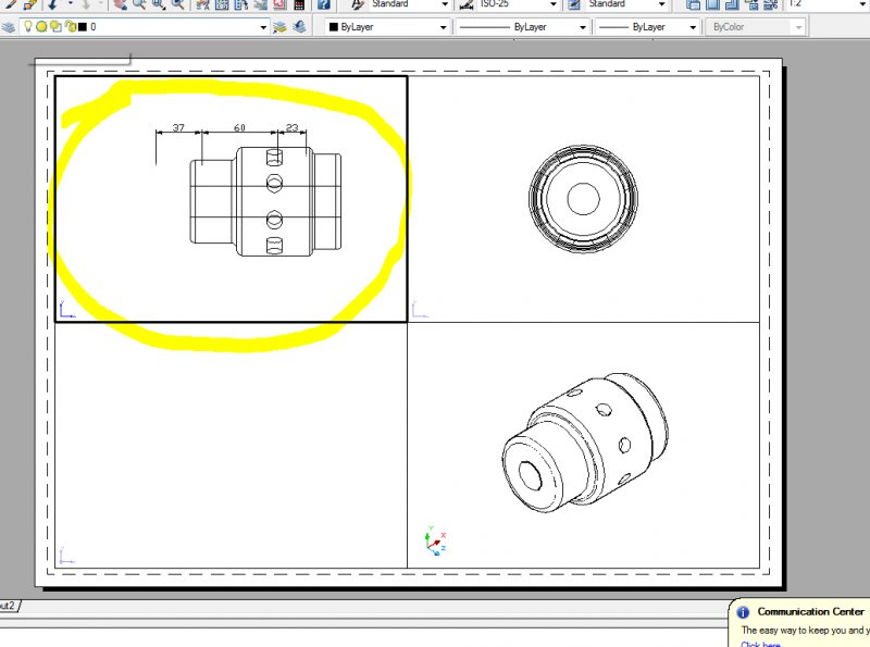

m2double Posted July 15, 2011 Posted July 15, 2011 Is it possible to make the dimmentions (drawn in the layout tab) to follow the object (drawn in the model space) when it is moved? Quote
MSasu Posted July 15, 2011 Posted July 15, 2011 Seems that you placed the dimensions on PaperSpace. Sorry, but this is wrong!. Should activate that viewport and add the dimensions in ModelSpace trough PaperSpace. Don't forget to check the option: Dimension Style -> Fit -> Scale dimensions to layout. A work-around for your current case is to use the command CHSPACE. Regards, Mircea Quote

MSasu Posted July 15, 2011 Posted July 15, 2011 If the OP decide to add the dimensions in PS (a method that I, personally, don't like at all, but may produce a good drawing as ReMark stated) then he/she must ensure that when try to move a viewport, he/she select all corresponding dimensions. Regards, Mircea Quote
MSasu Posted July 15, 2011 Posted July 15, 2011 A theoretical solution is to create one block from each viewport and the corresponding dimensions – not sure how practical this will be in “real life”. Regards, Mircea Quote

RobDraw Posted July 15, 2011 Posted July 15, 2011 Is it possible to make the dimmentions (drawn in the layout tab) to follow the object (drawn in the model space) when it is moved?QUOTE] I could not test in 2008 but if the dimensions are associative, they will move along with the object(s) when moved. See what I did there guys. I did not criticise or offer alternative methods. I found out that it is possible to do what the OP asked. I don't even use dimensions and I answered the question at hand. Is that so hard? Quote

Pablo Ferral Posted July 15, 2011 Posted July 15, 2011 So the answer is yes - but it's really flaky. However - as you have a 3D object there, it is really the only way to dimension the object. You might look into 'SOLDRAW' and 'SOLPROF' or 'FLATSHOT' to create 2D blocks of your 3D model which can then be dimensioned in model space. Or you could upgrade to 2012 which has new 3D model documentation tools which work like Inventor. Quote

m2double Posted July 18, 2011 Author Posted July 18, 2011 Thanks everyone, I think Associative Dimensions is good this time - motivation was to have dimention that doesn't change the size depending on object scale in the Paperspace. Quote
