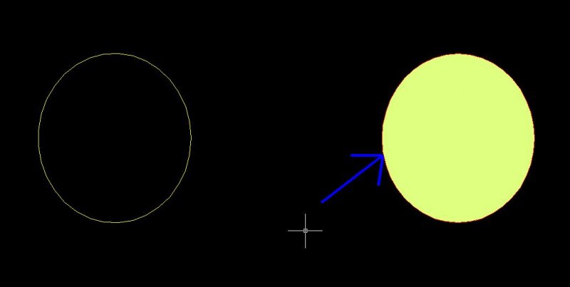

luiscarneirorm Posted July 15, 2011 Author Posted July 15, 2011 The marked limit is what I want to select Quote
Tharwat Posted July 15, 2011 Posted July 15, 2011 That's also not a line , it is a circle isn't it ? Quote
ketxu Posted July 15, 2011 Posted July 15, 2011 [ATTACH]28722[/ATTACH] The marked limit is what I want to select Just post ur drawing ^^ Quote
luiscarneirorm Posted July 15, 2011 Author Posted July 15, 2011 That's also not a line , it is a circle isn't it ? yes. is this hatch limit of what I want to select Quote

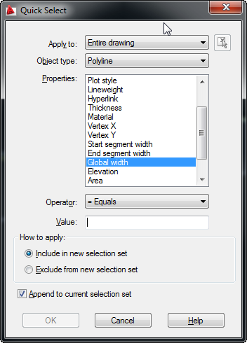

SLW210 Posted July 15, 2011 Posted July 15, 2011 I believe he is wanting to select the hatch BOUNDARY. He is also wanting to select all entities with a LINEWIDTH greater than a specified WIDTH. QSELECT will do both. Quote

BlackBox Posted August 29, 2011 Posted August 29, 2011 QSELECT will select polylines with a specified *global width* Quote

SLW210 Posted August 29, 2011 Posted August 29, 2011 QSELECT will select polylines with a specified *global width* [ATTACH=CONFIG]29701[/ATTACH] You also have greater than, not equal, = equal and select all options for the operators. Quote

luiscarneirorm Posted August 29, 2011 Author Posted August 29, 2011 with QSELECT I can do it, but if the entity has lineweigth by layer, it is not selected Quote
