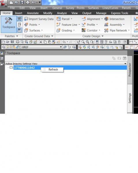

I'm trying to set a coordinate system in Civil 3D 2010 but when I go to the Settings tab in Toolspace and select the drawing name, then right click, I don't get the Civil command options you normally see like, General, Point, Surface, Parcel, etc.
Take a look at the attachment I've labeled 'Toolspace' below and you'll see what I'm talking about. I'm in the right spot.
The drawing file came from an outside source and each time I open it I get a message that the drawing was created from a newer version of Civil 3D and that all the entities are in a proxy state [whatever that is], and that all commands, settings, etc. are disabled for this drawing. See the other attachment I've labeled 'Proxy'.

Reinstall 2012, seems self explanatory "This drawing was created with a newer version of Civil 3D".
