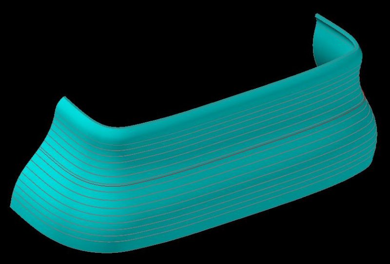

Jack_O'neill Posted July 14, 2011 Posted July 14, 2011 my machine swept it as is. it sat there and thought about it for nearly a minute, but it did it. It created a 1.12 mb file, which zipped is till almost 800K (too big to post here). If you want it, I'll email it to you. Looks like this: Quote
