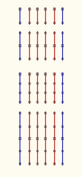

just only one thing, i explained wrong is that the lines has to be vertical, but the distance divided horizontaly...
I've attached i picture to this post, to explain more understandable...here is some things about this programs I want to do:
1. First and last lines always are blue.
2.All the lines belong to layer - profile
3.the Squere block on the lines belong to layer kons1
4.The circle block on the lines belong to layer kons2
5. distance between all the circle and squere block never is bigger then 70 (all the gaps between ar equal),if needed, aditional circle blocks can be added to the line.
6. Distance from the line start/end till the blocks are always 10.
So if someone wants this challange, and want's to help me out, pls feel free... becouse as I see, for me it would take ages to make a program like this, and here first post came after several minutes...lines.jpg
[ATTACH]28609[/ATTACH][ATTACH]28610[/ATTACH]... In other case thnx, I will share my lisp whit you anyway later, just to know what you think about it :)

ok blue lines v's red the repeat n is number of bars so the red's are n-2
This is not tested just cut and pasted. expects layers red & blue to exist.
(defun c:vlines ( / p1 p2 h n v )
 (if
   (and
     (setq p1 (getpoint "\nSpecify First Corner: "))
     (setq p2 (getcorner "\nSpecify Opposite Corner: " p1))
     (progn (initget 6) (setq [color=red]numline[/color] (getint "\nSpecify Number of Lines: ")))
[color=red](setq n (- numline 2))[/color]
     (setq h (if (= 1 n) 0. (/ (- (car p2) (car p1)) (1- n)))
           v (- (cadr p2) (cadr p1))
[color=darkred][/color]
[color=darkred]       (entmakex
         (list
           (cons 0 "LINE")[/color]
[color=darkred]            (cons 8 "blue")
           (cons 10 (trans p1 1 0))
           (cons 11 (trans (list (car p1) (+ (cadr p1) v) (caddr p1)) 1 0))
       (setq p1 (list (+ h (car p1)) (cadr p1) (caddr p1)))
[/color]      (repeat n
       (entmakex
         (list
           (cons 0 "LINE")
[color=red](cons 8 "Red")[/color]
[color=#8b0000]       (entmakex
         (list
           (cons 0 "LINE")
(cons 8 "BLUE")            [/color]
[color=#8b0000](cons 10 (trans p1 1 0))
     )[/color]

BIGAL somehow it doesn't work for me... Now mater how many amount of lines I enter, it always gets me one line without any color.. Is it just for me like this?

I do admit I didn't test it but what I am saying is you need to subtract from the number of segments 2 you then draw 1 line on one layer "Profile1" you then draw n-2 lines on layer "profile2" you then draw the last line on layer "profile 1.
What I was getting at is you need to change Lee's code to do 3 entmakex in the routine, put 1 before the (repeat n and one after the end of the repeat function.
Lee a suggestion to help the problem for rekoj please note code is not tested as no autocad at moment need to check brackets.
For rekoj using the defun "makeline" makes it easier to repeat a simple function multiple times but with only one variable change in this case the layer name more defuns can be added to place the circle blocks etc also and have different ones at different locations. using this you can create a multi lines question rather than 1 row at a time.

Using a counter (as in my code in post #17) there should be no need to have multiple repeat loops.
