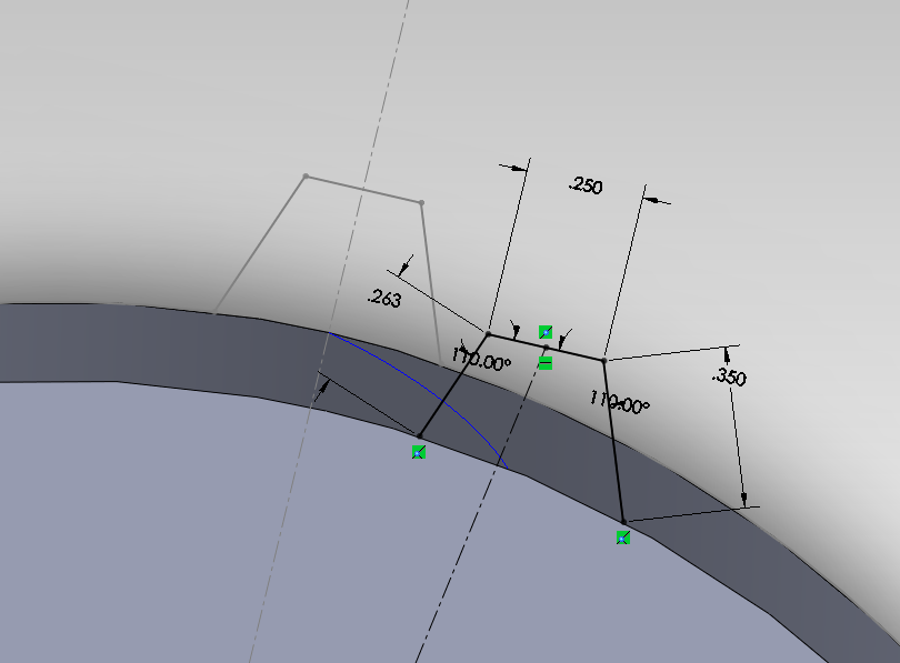

Here is where I am at with the second sketch.
If you look closely, the left side of the tooth should be .35 to match the right side. If I make that dimension .35, it makes the tooth directly across from the opposite tooth AND fully defined, thus making the curved line pointless. I need to have that tooth exactly the same and still be able to have the centerline on the second tooth mate to the curved line.

Switchblade, the issue is the Auto-relations that happen. You have a Horizontal relation on your top line when really it needs to be perpendicular to that dashed construction line. Select the line and you can delete the relation from the property window in the feature manager. Then you can apply the perpendicular relation.
Also I drew the front profile, back profile and then the arc to connect them. It all depends on how you need to define your gear. Do you have any specs to work off of?
