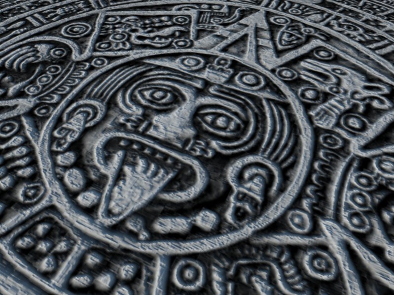

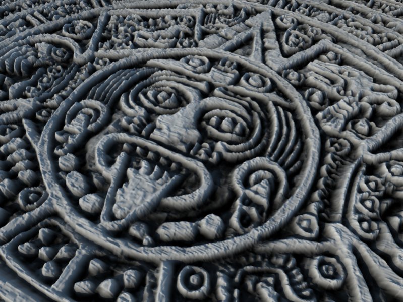

well yes, my bad. it does affect the surface. XD. but what i mean is the detail in the resulting render stays the same no matter what amount of poly you have on the surface. to add/lessen the detail to your render using displacement maps, there is a menu under displacement that says maxsubdivs. there you can enter the amount of subdivs that would result in the amount of detail you desire for your render. i dont know if its true for 3ds max though. (but ive read somewhere that it is the same).
first image default settings max subdivs = 256, second image max subdivs = 5
these were done in SU. (still learning max)
Displacement is typically controlled in the material settings, but there is a Global Displacement Setting for "Max Subdiv" in the Mental Ray render settings. The default is 16k and the maximum amount is 64k.

  Cad64 said:
Can you see any difference between the two images?
Not really, the only difference is that the 132,000 poly's has a darker contrast in the overall image; however, there is no difference on the texture and effect. Again thanks to you all!
