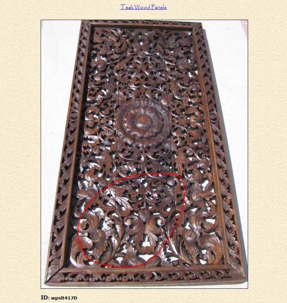

First of all, thank you guys. :) I provided some additional shots (I hope they’re not too large).
Image 1: Basically, I want to create the columns to look like the carved textured panel in the picture (with detail). The panel in the picture is what appears to be a door panel of some sort; however, it's being applied to columns/ceiling.
Carved Wooden Panel: http://www.nongnit.com/teakpanels/2x2/square/wpslt417/wpslt417D.htm
Image 2 & 3: The carving is supposed to wrap around the column, to give you an idea of what it looks like in a column.

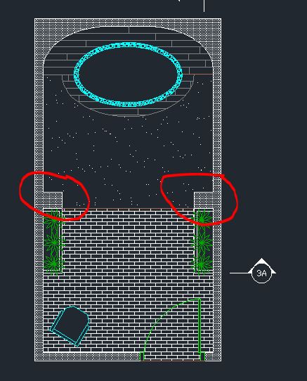

Image 3: I tried to do the “shell” modifier; however, it didn’t work because I had of the number of vertices (about a million!), which kept disappearing. I proceeded to “extrude” and it worked by capping it off.

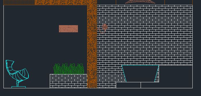

Image 4: Then, I went into the CAD file to create sample grouping of polylines, which takes forever, but I was able to adjust various carving heights. I had to stop because I encountered a problem--- for some reason my segments, elements, etc. are black and I am unable to adjust the color. The color I have assigned shows only on the selection outline. I had to do some sample renders, in order to see the height variations. I still can’t figure out how to change that back. (I wonder if it has to do with the linked layers from CAD). I haven’t come across any topics on that subject, yet. : (
Like I said I greatly appreciate everyone’s time, there’s no rush, thanks! : )

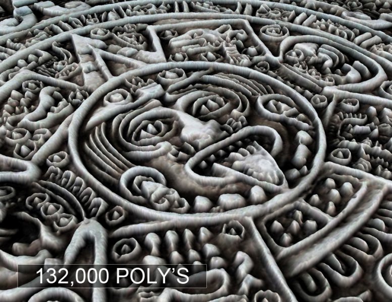

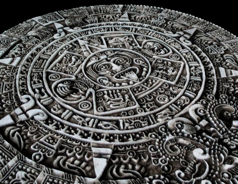

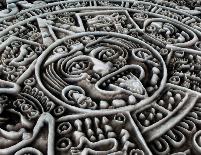

That's true to a certain extent. You can't apply a displacement map to a plane with only 8 poly's and expect to get anything recognizable, but you also don't have to go crazy and have a super high poly model to get good displacement either. Take a look at what I did below. I created a plane which is 126' x 126' with 256 length and width segments, a total of 131,072 poly's. So it's pretty low poly, relatively speaking.
I found an image of the mayan calendar online, took it into Photoshop and cleaned it up a little bit. Then I quickly created an opacity map and a displacement map from the diffuse map and loaded everything into a material slot in the Max material editor.
I applied the material to the plane, hit render and below is what I got. Now remember, the texture I used is not the cleanest, it's just one I quickly found online. If I had a cleaner texture map I could get better looking displacement, but this is still pretty good for spending only about 20 minutes on this.

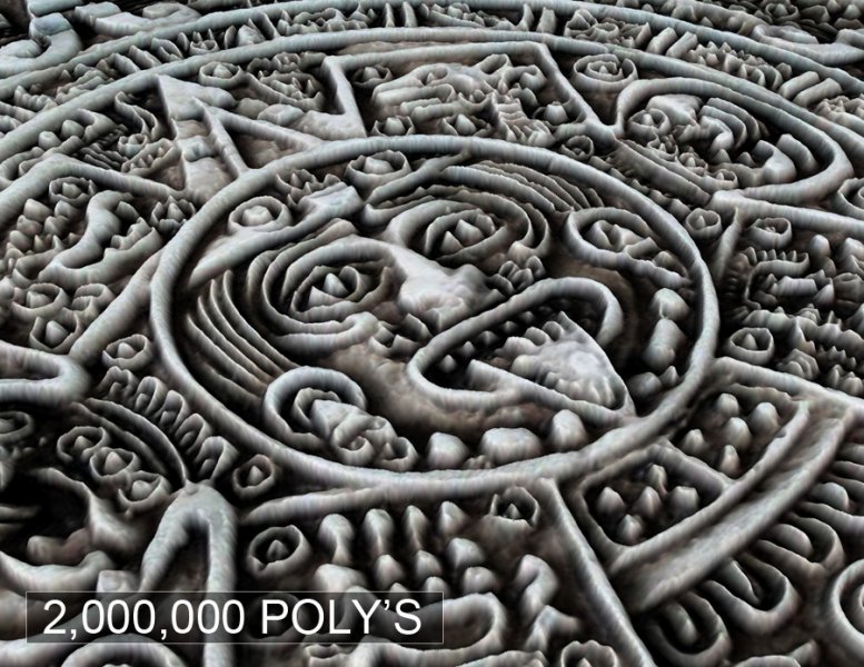

Now, just to show that you don't need super high poly models for displacement, here are two renders of the same view. The first one is the 132,000 poly plane from the previous post and the second is the same plane with the poly count ramped up to 2,000,000 poly's. Can you see any difference between the two images?
i can see that the image with 2 million polygons is somewhat smoother than the image with 132k polygons
I think you're seeing what you want to see. Either that or you've got much better eyes than I do. I don't see any difference at all. :unsure:
possibly :sweat:, i ran some of my test and i found the even with a lot of polygons there isnt really enough of a difference to get a higher rating but of course you should not use a low poly value. also with a larger resolution bitmap the results obtained are better.
