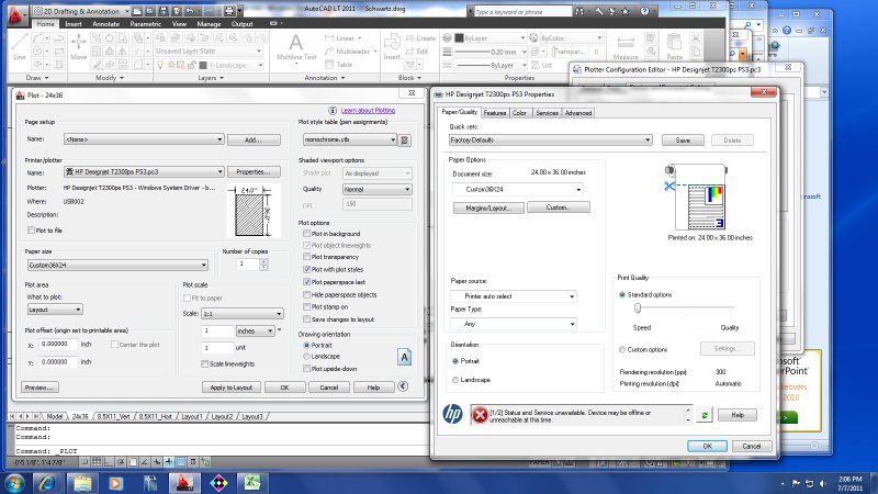

hello. I have tried numerous times to make my paper size and actual plot size the same. My paper size is 24 x 36 but for some reason it rotates the paper and the output is 36 x 36, every time!
When I look at it on the preview, it looks correct but then the paper comes out with a foot of paper at the top of the drawing.
I've created new page sizes, etc. Can anyone help me with this? pls?

Here it is.
my roll is 3' wide and most drawings are only about 2' tall. but it trims it with an extra foot at the top, which is wasteful and looks sloppy.

try setting it to landscape intead of portriat

I think Landscape might work.

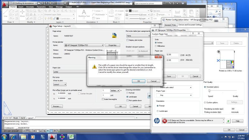

Per the margin suggestion I thought I would try and make a paper to compensate the margin width.
I find this warning confusing....
make the plotter configuration selection ladscape as well and set the custom paper size to 22 X32, rather than 32X22, also you might play with a 22X34 sized sheet.
... wait, maybe i'm backwards now, i think it should be 32x22 ... now i'm confused lol
Your paper size selected is letter.
Select the paper size Arch D (Landscape)
