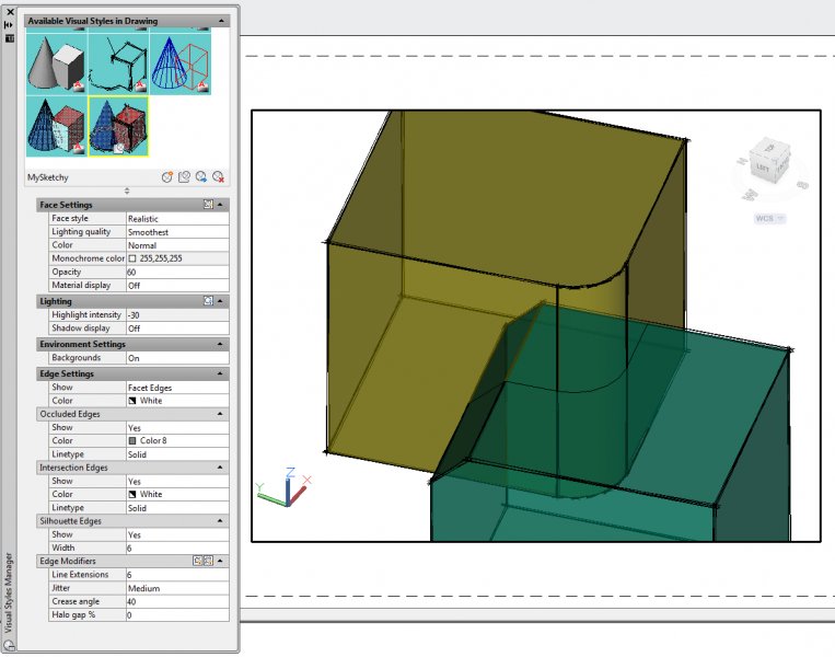

E.g. here I've opened the Visual Styles Manager (VisualStyles command), right-clicked on the standard Sketchy VS and selected Copy, then right-click on a blank spot in the top "Available Visual Styles in Drawing" group and selected Paste. Right-clicked on the new VS and selected Edit Name and Description - renamed it to "MySketchy" (just because I can :P). Then (while inside the VP) double clicked on it.
Then I changed some of its settings: Face style=Realistic, Lighting quality=Smoothest, Occluded Edges (Show=Yes, Color=8 ), Intersection Edges (Show=Yes).

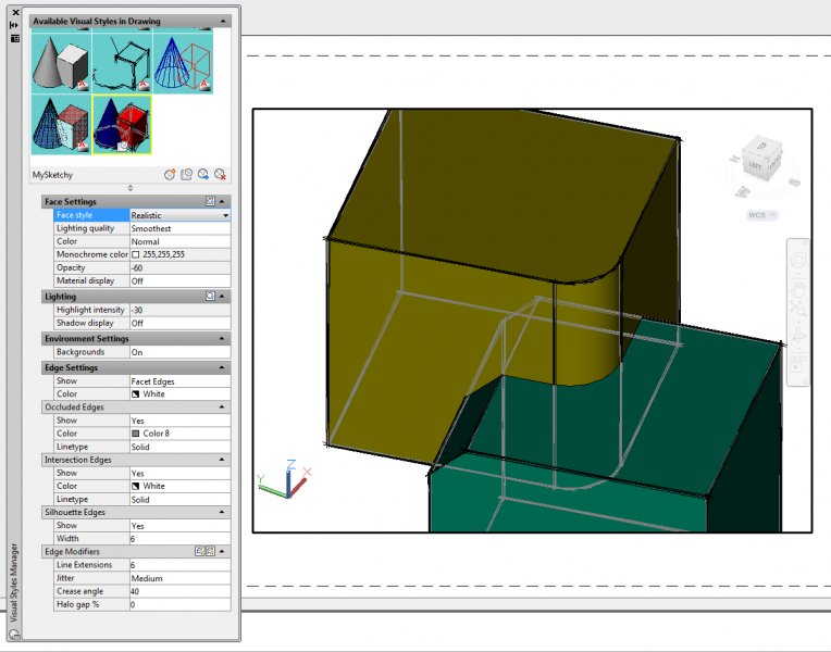

BTW, you'll note some of the properties in the VS manager is greyed out. To turn them on you can use the icons on the right of each groups title. E.g. here I've turned on the Opacity by clicking its icon in the "Face Settings" group's heading.
