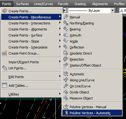

I just noticed you have Civil 3D. Why not just create points and use the point number/description to label the polyline vertices? Would make things a lot easier and could be quickly dumped to send to a data collector. This method is really good for creating state-out work for crews.
Thanks for that alanjt. I'll check it out tomorrow.
No problem. C3D is incredibly powerful. Do yourself a favor and explore some of the menus. :)
Will do but our surveyors don't have civil 3D. They have map. I'll look into anyway. thanks.
