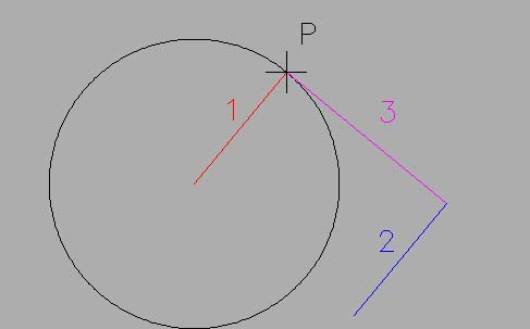

Hi.
My question is:
Imagine you have drawn a circle, and at a specific location of its circunference, you want to construct a tangent line, How can I do it.
You can tried to "get" the exact tangent point, but that`s guessing.
Thank you a lot.
Start the line command, pick a point away from the circle, use the TAN osnap, pick on the circle.
1. From the point P on the circle, draw a line to the centre of the circle.
2. Offset this line.
3. Draw a line between the ends of the lines. This is the required tangent :D

Like eldon version 2 draw line from centre to point on circle then rotate line 90degs its tangential.
