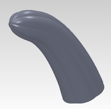

epheterson Posted June 29, 2011 Posted June 29, 2011 So this isn't my first rodeo in SolidWorks, but I've found myself a little stumped when modeling a banana. It's the inside of a banana, so not the geometric peel. It begins a cylinder then I'd like to model the tip something akin to this picture: I'm thinking I need either a curve, or multiple planes offset from each other at different angles. I'd put multiple cross-sections on these planes, or along the curve. I'm not sure how to create planes like this, and not a simple way to get the curve in. You think this would be easy, any suggestions? Quote

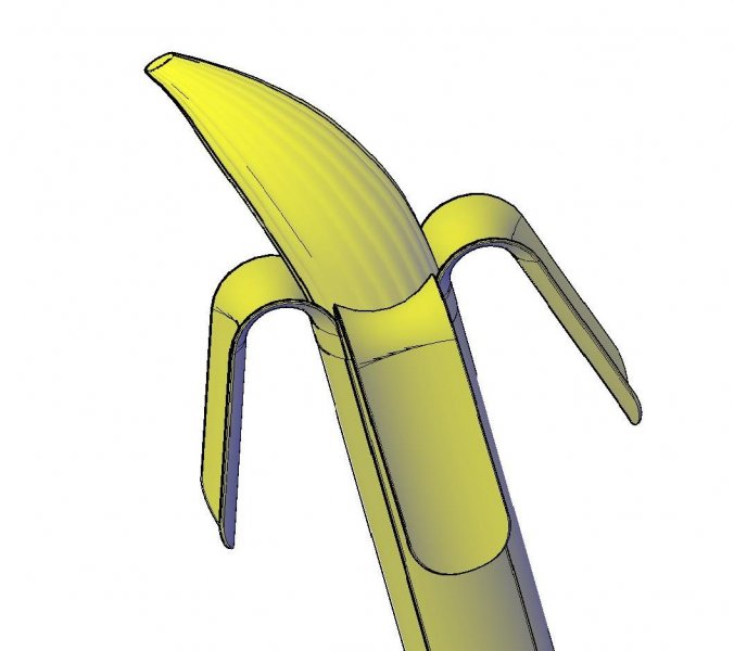

Jack_O'neill Posted June 29, 2011 Posted June 29, 2011 I only had a few minutes to play with it, so I didn't do the part with the peel. Never tried to draw a banana before. Got more work to do on it, but the basic shape is almost there. Got somewhere to be most of today, but when I get back I'll play with it some more. Don't quite have the ribs the right shape yet, but it was good enough to try the concept. Did this in Autocad. Drew the bumpy shape, then a curved path. Copied the bumpy shape along that path in a few places. Towards the small end, I scaled the bumpy shape down a couple times, then lofted along the path. Like I said, I'll make it look better when I have more time. Best I could do in the 10 minutes I had to play with it. Quote

Jack_O'neill Posted June 30, 2011 Posted June 30, 2011 ok, round two with the banana (yes, it's autocad, and no, it's still not finished). I haven't used it since '93, but I caught myself thinking "man, this would be so much easier in Mechanical Desktop". Quote

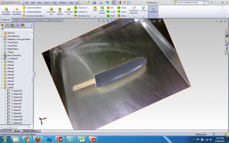

epheterson Posted June 30, 2011 Author Posted June 30, 2011 Y'all are awesome! Jack, I attached shift's model and don't know if you caught the memo but I was doing just the banana, not the peel! I figured a way to do it by importing an image, creating planes parallel to Front every 20mm, creating a circle sketch to fit on the image and drawing a top & bottom spline to touch each circle I created. Almost a perfect method for any image I can find! Then I can tweak once I have something. :D:D Quote

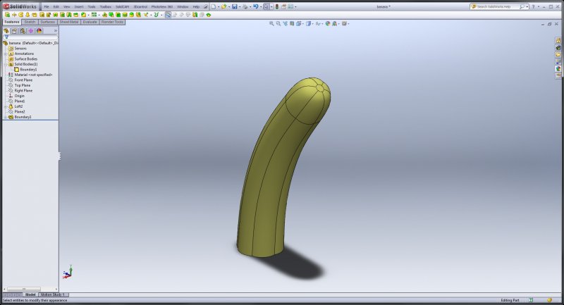

shift1313 Posted June 30, 2011 Posted June 30, 2011 Jack, here is a screen shot of the part i drew. The main body was a loft between two profiles with a center line path. The profiles were the same only a different scale. There was an inscribed circle of 1.5" and 1.25" for each profile. The end was done with a boundary operation but a loft would have worked as well. I drew the same profile on the end with a 0.5" inscribed circle and used tangency between the first them. Plane 1 was created based off a spline i drew for the path so i had a plan normal to my path for the second profile. ps, i know its a banana but i feel really wrong about drawing this and posting the picture online Quote
epheterson Posted June 30, 2011 Author Posted June 30, 2011 Shift, I know what you mean... you should hear my roommate's comments. Anywho I see how you constructed that but how do you get three planes on one continuous curve? You drew a spline from vertical to 1st, and say you did a boundary condition on 3rd, but 3rd looks angled further. Quote

shift1313 Posted June 30, 2011 Posted June 30, 2011 epheterson said: Shift, I know what you mean... you should hear my roommate's comments. Anywho I see how you constructed that but how do you get three planes on one continuous curve? You drew a spline from vertical to 1st, and say you did a boundary condition on 3rd, but 3rd looks angled further. I only have 2 planes in there. I drew a sketch on the Top Plane for my first profile. On the Right plane i drew my spline path. I then created a new plane by selecting the spline and its end point. This will make a plane that is normal to the curve at the end. The last plane was an offset of this plane just to draw the end profile. Quote
