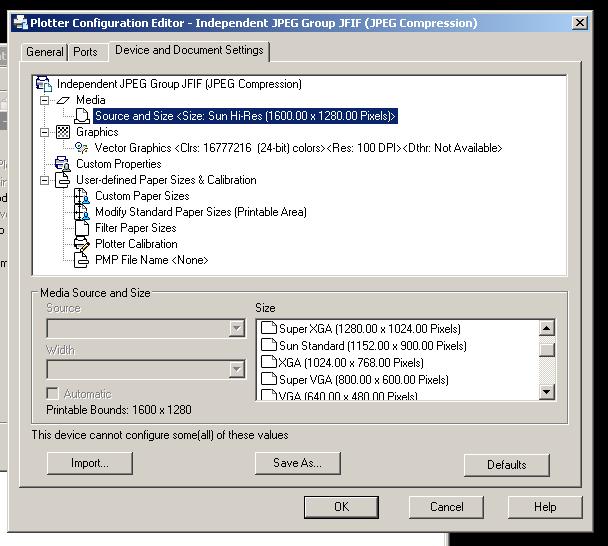

Jack_O'neill Posted June 27, 2011 Posted June 27, 2011 You can control all that by using the "add a plotter wizard" and choosing the Independent JPEG Group as the plotter. Quote

Jack_O'neill Posted July 9, 2011 Posted July 9, 2011 atulkumarengineer said: Sir,can you explain step by step procedure. Thanks in advance Regards, Atul Go to the "file" menu and down to "plotter manager". That will open a window with several options, so double click on the add a plotter wizard shortcut. When the "add plotter introduction page" pops up, hit "next". Check to see that the "my computer" radio button is selected and hit next again. When the next screen opens, under "manufacturers" scroll down and select "raster file formats". Then in the "models" window, select "independent jpeg group..." and hit the "next" button twice. On the "add plotter ports" screen, make sure "plot to file" is selected and hit next again. If you want to rename the Jpeg thing, you can do it now, or leave it and hit next again. Then hit "edit plotter configuration" and the dialog box from my previous post will appear. You can then click on and edit any available parameters to suit yourself. There are context sensitive help buttons along the way if you need more information. Quote
