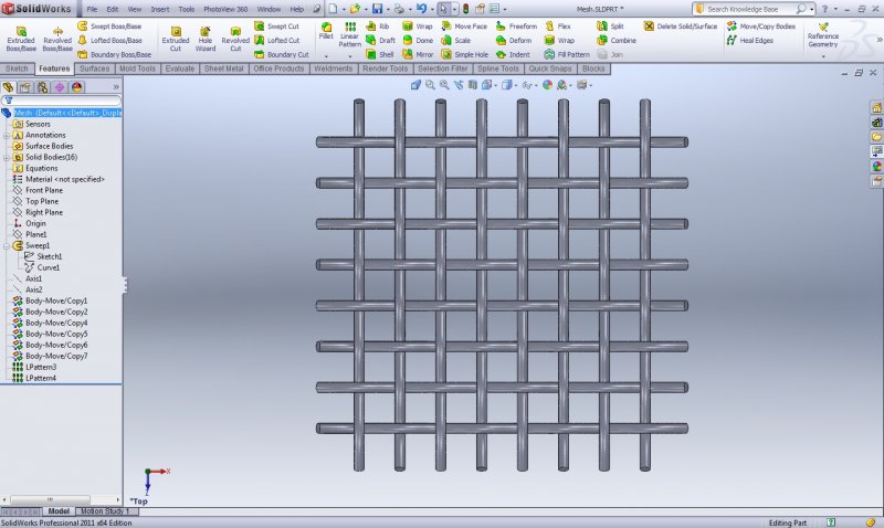

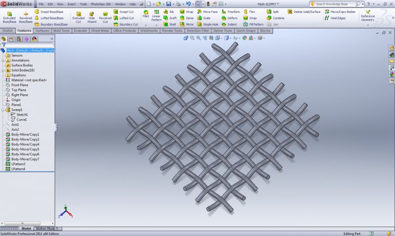

bhamze Posted June 27, 2011 Posted June 27, 2011 Sorry, the option to save in 2010 is not possible. Here are a few screen shots. I will try to post the procedure later, let me know if your interested. Quote

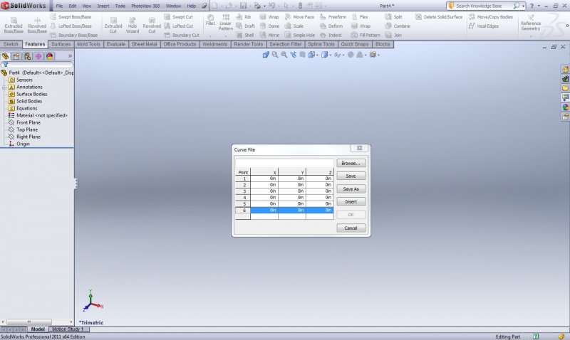

bhamze Posted June 27, 2011 Posted June 27, 2011 Here you go. Ive attached the .txt file for reference. Hope it helps. Mesh Curve.txtFetching info... Quote
bilalbajwa Posted June 28, 2011 Author Posted June 28, 2011 (edited) That's is so cool. Thanks a lot. I never thought i will get a video in response. I am still wondering how you generated the text file . What are all those values in text file. I have a wire mesh in hand and i want to run analysis on it. I also have a digital vernier caliper to take the measurements but I don't know what the values in text file are? Please explain. Thanks a lot for help. Edited June 28, 2011 by bilalbajwa Quote

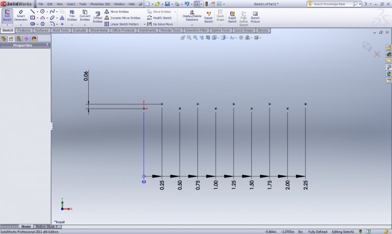

bhamze Posted June 28, 2011 Posted June 28, 2011 The text file was generated in Excel and is used for "Curve Through XYZ Points" in SW. The values in text file reference the XYZ coordinate system. When you use this feature you can enter data manually or import a text file. In this example we only want to create a curve on the XY plane. Therefore our Z value will be set to "0" for all points. See attached photo, I created a sketch and dimensioned the points so you can understand how I generated the file. Create a new part using the Curve Through XYZ point feature, enter the values manually based on image below. You will end up with a curve identical to the one I created. Quote
