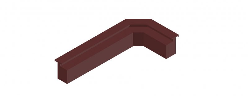

3D isnt really my thing but i have been asked by friend to help design a bar, as in a drinking bar that will be in a pub. I have a view of the end of the bar, it is going to be constructed with 100mmx50mm timber cladded with 22mm ply wood. I have a side profile, a front profile, and the path that i want the bar to travel along. I know there should be a a command to easily make a 3d image of this, but i am struggling after two days on and off to make this happen.
The arrow shows of the side profile shows where i want to place the bar on the path.
I may have tried to 3d the profile alread, without success....sorry if it is messy
i run autocad MEP 2011

so do you just want to extrude the profile (section through the bar) along the chamfered path shown on the right?
Try either the EXTRUDE or SWEEP commands.

i have extruded the bar, but not how i want it....doughnut! any advice on how to un-extrude an object? then i shall try sweep,

Is this what you were looking to do?
thats is the one!!

s100cky: Your drawing of the bar profile had some inherent problems. You had too many small line segments some of which overlapped each other. I ran the OVERKILL command and selected the entire object. AutoCAD detected 16 overlapping objects. This will cause problems when extruding. My solution was to trace the perimeter of your drawing using a polyline then extruding that.

The reason you got this result is you extruded the individual lines that went into making the profile. You ended up with surfaces. You also did not use the "Path" option to extrude the bar profile all the polyline path you had created.

If you had created the profile using the polyline command and just traced out the perimeter of the bar you'd have 99% of the job done. The only remaining bit to do would be to use the SWEEP command and pick your polyline (the one with the 45 deg bend in it) "path". Now the result might have to be rotated. The other method would be to move the profile to the path, reorient your UCS, then rotate the profile perpendicular to the path. At this point you could use the EXTRUDE command instead.
As far as editing the bar to add cabinets and shelves you might have to get into using the Subtract command to create voids.
