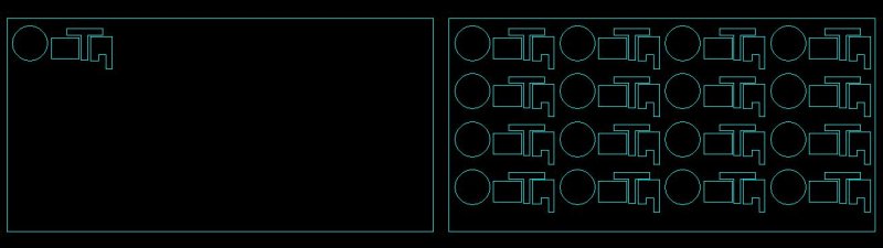

CyberAngel is right, there's no tool that will arrange the objects for you. Once you bring in your photo as he describes and get all your objects drawn, you can then draw a rectangle the size of your sheet of veneer and place the objects inside it. You'll just have to move them around till you get a placement that takes best advantage of the material. Once you have the first group like you want it, you can then do a rectangular array to fill the sheet.
