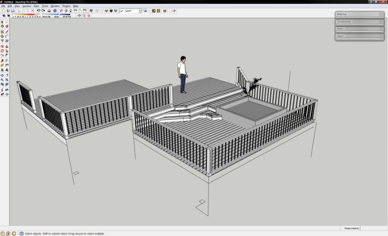

f700es Posted June 21, 2011 Posted June 21, 2011 I applaud you for using CAD for this but in all honesty this is what SketchUp was made for. You can knock this deck out in 1/4 of the time in SketchUp and even show materials. This design is just for you, not an assignment or any other required method. Just for you and the builder to get together on some ideas. In my screen print above I have it in sketchup but no reason to just not start it in there to begin with. You obviously can use AutoCAD so sketchup will be easy to pickup. I know I give this as an answer sometimes but it really is that easy. Edit: Model this in SketchUp and then throw it in Kerkythea (rendering engine) and you will have a sweet image! Quote
