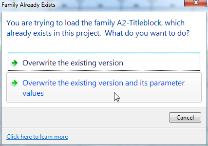

irneb Posted March 11, 2013 Posted March 11, 2013 When you redefine the family (i.e. you load it into your project) a dialog like this should open: Click the 2nd option to overwrite the family's definition and ALSO its values in the parameters. If you click the 1st option, only the definition is overwritten. Moral: Read what you're clicking on before clicking it. I've found lots of people using Revit complain about stuff "going wrong" - only to find that they tend to just click on messages / error warnings without even trying to understand why they occurred. Nearly always something not working / simply "disappearing" is because of one of those warnings which you simply clicked on the OK / Continue button without noticing that it was saying that some stuff are going to be deleted / links broken / etc. Same principle goes for this - the override dialog has 2 options, but most only read as far as the 1st few words of the 1st option. Quote
