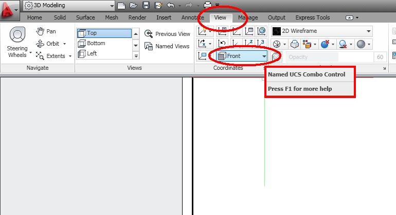

nestly Posted June 16, 2011 Posted June 16, 2011 If you want to know were to find the UCSII toolbar controls in the Ribbon, they're on the "View" tab Quote
