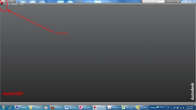

khoshravan Posted June 15, 2011 Author Share Posted June 15, 2011 Can you make a print screen of your "A" menu? It is not clear to me what you mean. Actually it is not a menu. It is an icon in red in the top-left most part of the window and some menus have here like "options" Quote Link to comment Share on other sites More sharing options...
Oppie Posted June 15, 2011 Share Posted June 15, 2011 [ATTACH]28192[/ATTACH] Actually it is not a menu. It is an icon in red in the top-left most part of the window and some menus have here like "options" Then I understood you well. Still use ALT + F the only difference is that if you don't have a drawing open that the menu looks different. Quote Link to comment Share on other sites More sharing options...
nestly Posted June 15, 2011 Share Posted June 15, 2011 [ATTACH]28192[/ATTACH] Actually it is not a menu. It is an icon in red in the top-left most part of the window and some menus have here like "options" It's called the "Application Menu" ... And I can't find what isn't in File that is in the A-menu? The Search Bar is the most notable. The Application Menu streamlines a lot of tasks that require opening separate dialogs if you perform the same task from the File Menu. Oh, I don't know what the shortcut is either when Menubar=1 Quote Link to comment Share on other sites More sharing options...
