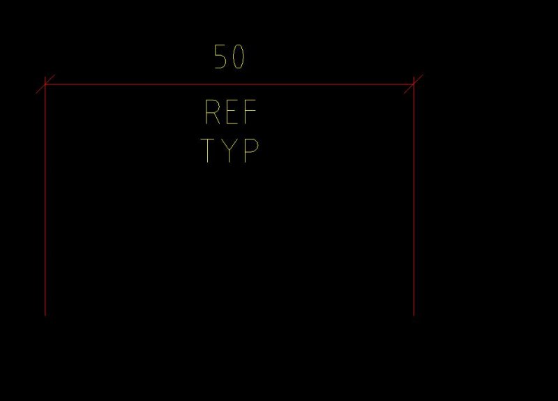

Also... is it possible to have multiple lines of notes added below a dimension?
like this...
thanks again.
(defun c:test2 ( / ss i e )
 (if (setq ss (ssget "_:L" '((0 . "*DIMENSION"))))
     (setq e (entget (ssname ss (setq i (1- i)))))
     (entmod (subst (cons 1 "<>\\XREF[color="#ff0000"]\\P[/color]TYP") (assoc 1 e) e))
will any of these routines work on dtext or mtext? i would mainly use these routines to run on dimensions, but would also like to use them on normal text.
You could use the "\\P" string to insert a new line to the end of an MText string, however, for DText you would need to create a new DText object at a distance below the original calculated from the text height of the selected DText and a Line spacing factor (such as 1.5).
