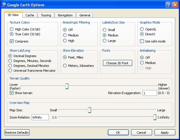

eldon Posted June 15, 2011 Posted June 15, 2011 I already converted the coordinate from " ' and degrees into x y z coordinates but this did not work Did you remember that a degree in the North-South direction is not the same length as a degree in the East-West direction Have you tried to set the Show Lat/Long to Universal Transverse Mercator when you are using Google Earth? Quote
