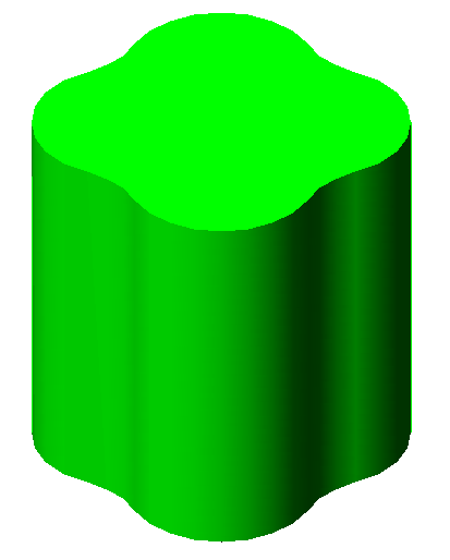

huygen Posted June 15, 2011 Author Posted June 15, 2011 Quote Lots of masters on here. What exactly are you trying to achieve? That's great! I would like to ask for a help. Please create a 3-points perspective drawing in AutoCAD of mine. The 3D plot will looks like the image I've attached in this reply. 3-points perspective.dwgFetching info... Quote
Bill Tillman Posted June 15, 2011 Posted June 15, 2011 Doing things along what you call a 3 Point Perspective, and by that I assume you're meaning X-Y-Z coordinate system or line of sight + horizon line + vanishing points...everyone has their own way of doing 3D sketches. As for this shape, I would simply layout the face view of it, PEDIT the lines and arcs to form a polyline, then EXTRUDE it to the thickness you want. That's one of the nice things about 3D drawing in AutoCAD, the complicated stuff can be left for the software to figure out for you. And like I said, there are many different ways to make this 3D shape. Your method may differ from mine but we'll end up with the same thing in the end. Quote
qball Posted June 15, 2011 Posted June 15, 2011 You've already got the base shape done, so as Bill said, PEDIT > Join the arcs together, Extrude. Then use viewports in Layout Tab and the View Cube to create the perspectives you want. Quote

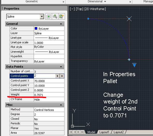

SEANT Posted August 6, 2011 Posted August 6, 2011 To illustate how to change the weight of a Control Point via the Properties Pallet. Quote

huygen Posted August 6, 2011 Author Posted August 6, 2011 Quote http://www.cadtutor.net/forum/showthread.php?60137-3-Points-Perspective-Drawing-Using-AutoCAD&p=418961&viewfull=1#post418961Can you explain me why the value should be 0.7071? Is there any mathematical explanation on this? Is it about, for example, Bezier curve, etc.? Where I can find the mathematical theory and exercises by reading book? What book is it (title, author, publisher, etc.)? Quote
SEANT Posted August 7, 2011 Posted August 7, 2011 (edited) SuperCAD said: If you use PRESSPULL, you may not even need to join the lines together. It should recognize the boundary and extrude the shape you want. A perspective via 3D would certainly be the conventional approach; this exercise, though, is more about exploring the geometries involved with the traditional 2D Perspective. huygen said: Can you explain me why the value should be 0.7071? Is there any mathematical explanation on this? Is it about, for example, Bezier curve, etc.? Where I can find the mathematical theory and exercises by reading book? What book is it (title, author, publisher, etc.)? The math that forms the basis of Splines (NURB curves)forces that condition. A Weight of Cos(IncludedAngle/2). See how the weights differ in the attached drawing. Bezier Curves are a subset of NURB Curves. Beziers (and the underlying math structure) do not allow for weights other than 1. A very good resource for these types of curves can be found here: http://www.cs.mtu.edu/~shene/COURSES/cs3621/NOTES/ ThreeSplineCircs.dwgFetching info... Edited August 13, 2011 by SEANT Quote
