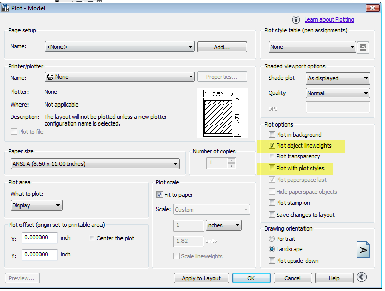

Are you plotting with plot styles or have lineweight turn on in the plot?

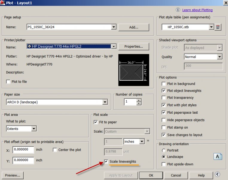

Are you printing from PS or MS? If you are plotting model space objects in a layout (paperspace) is scale lineweights checked.

rkent: I plotted the file you attached in model space and you can see the different widths of the lines. However, when plotted through a viewport in paperspace all the lines are the same width. Where do I find the "scale lineweights" check box?
Murph_map: I plot with plot styles checked.

I actually figureed it out--my .ctb file was modifed and that pen was set to 0.00 instead of "Use object lineweight."

I'm just wondering if he actually wanted STB instead. The CTB works with the colours of lines, while the STB allows you to set the actual "pen" used per entity/layer independent of what colour it is. If you go with the LineWeights per entity/layer, then in both CTB & STB you need to have at least one colour/pen set to use object lineweights - otherwise the object lineweights are always ignored. So you actually have 3 options, 2 of them are mutually exclusive, but the lineweights thing can be combined.
Our CTB uses all ACI colours from 1 to 7 set to black, with varying penwidths (ranging from 0.08mm up to 1.0mm). 8 & 9 is set to black with object linewidth. Then all others (i.e. 10-255) is set to object colour & object linewidth. This allows for 7 different "pens" by selecting the colour only, but also allows for black and any other colour with a modify-able width. You can of course also use RGB/Pantone colours - which would always use object linewidths and object colours (no matter what's in the CTB), though RGB colours isn't as easy to work with as simply picking one (there's 16mil of them).
