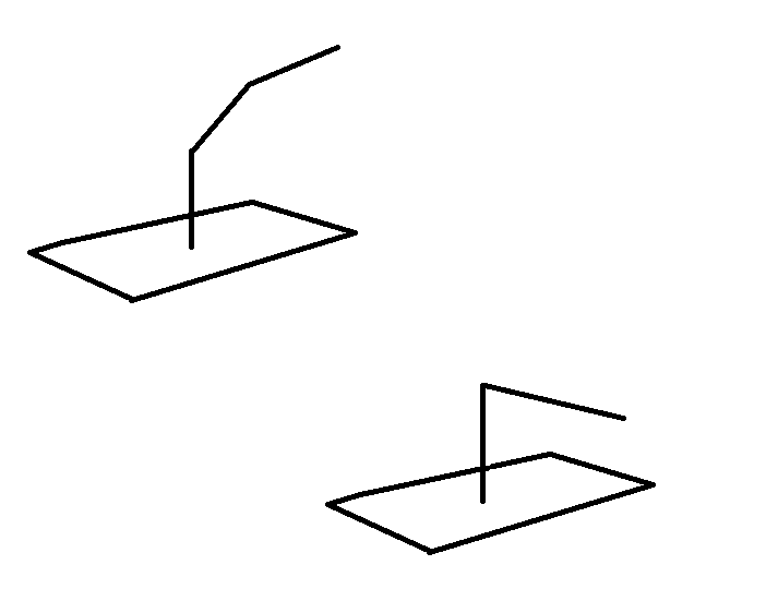

Yafim Posted June 13, 2011 Posted June 13, 2011 Hi, don't know if this is the place but help would be very..um..helpful I'm trying to create (in 3D workspace), a 3D polyline which starts from the "ground" and goes up the Z axis for 45 units (meters for example), then, the polyline continues "up" but in a 45 degree inclination, and then it goes up further but still 45 degrees from the last segment. I attached a picture of this to the post, the top line is the one I want to create, and the bottom one is what I get. The thing is that the 3dpoly command doesn't let me set the line on the Z plane, unless I fix it in ortho mode, and even after I do the first segment that way, the next one stays fixed in either the Z plane or the XY plane, but not in the 45 degree between them that I want.... Sorry for the long post, but this is really simple and I can't seem to do it. I hope you can help. P.S. - when I click the 3d polyline command, there are no options in the command area, just "specify first point...." - is this what should appear? no options? Thank you! Quote

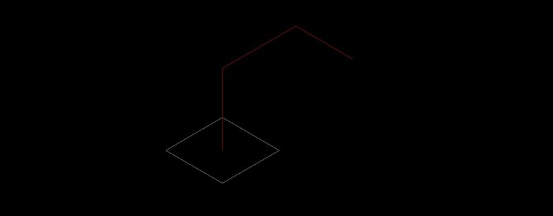

ReMark Posted June 14, 2011 Posted June 14, 2011 An example of my inputs start-to-finish. Command: _rectang Specify first corner point or [Chamfer/Elevation/Fillet/Thickness/Width]: Specify other corner point or [Area/Dimensions/Rotation]: d Specify length for rectangles : 12 Specify width for rectangles : 12 Specify other corner point or [Area/Dimensions/Rotation]: Command: UCS Current ucs name: *WORLD* Specify origin of UCS or [Face/NAmed/OBject/Previous/View/World/X/Y/Z/ZAxis] : x Specify rotation angle about X axis : 90 Command: _pline Specify start point: m2p First point of mid: Second point of mid: Current line-width is 0.0000 Specify next point or [Arc/Halfwidth/Length/Undo/Width]: @15.0 Specify next point or [Arc/Close/Halfwidth/Length/Undo/Width]: @22.0 Specify next point or [Arc/Close/Halfwidth/Length/Undo/Width]: @12.0 The result: Viewed from this angle (SE isometric) it's somewhat difficult to determine what angle the middle segement is drawn at. Quote

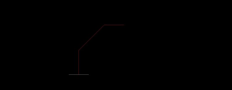

ReMark Posted June 14, 2011 Posted June 14, 2011 Viewed from the front it is now apparent which way the lines are going. Quote

ReMark Posted June 14, 2011 Posted June 14, 2011 M2P or MTP (either is correct) is a command modifier. It is used to find the centerpoint between two picked points. Use it after invoking the line command, for example, when prompted for a starting point. In my example I picked the midpoint of two opposite sides of my box. Reorienting the UCS allows the user to draw in different planes. Quote
