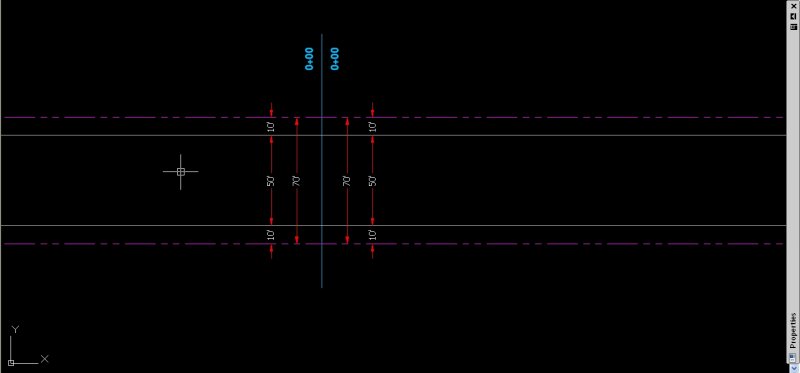

Is there a way to have dimensions posted on both sides of a selected line or block?
On both sides of our matchline, block attached, our dimensions are a set distance away depending on scale of drawing and go to specific layers, and rows are that same distance apart.
Such as:
30 Scale - 7' away from matchline
50 Scale - 14' away from matchline
100 Scale - 28' away from matchline
With two rows of dimensions.
1st row from the matchline - right of way to right of way
2nd row from the matchline - right of way to FOC/EOP/EOG/FOGLINE to FOC/EOP/EOG/FOGLINE to right of way
FOC/EOP/EOG/FOGLINE - meaning any of those 4 layers depending on the road type.
So ultimately the process would be:
1. Select the matchline block.
2. Prompt for scale
3. Depending on the scale create the 2 rows of dimensions the specific footage amount away, on both sides of the block
4. If selected multiple(s) of this block do a FOREACH and create dimensions at all of them.
Is this possible?

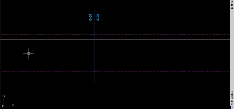

could you supply a before and after drawing of what it would look like
Before:
After:
