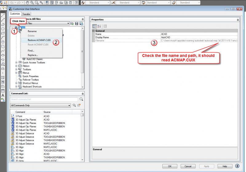

I am a AutoCAD Map 3D 2011 user. After one of our IS people worked on my PC to correct an issue with my web brouser (probably unrelated to my current problem but strangely coincidental don't you think?) I find that I am missing the MAP pull-down from the Map Classic Workspace. Can someone help me restore it? I have the other menu items (File, Edit, View Insert, Format, Tools, Draw, Dimension, Modify, ?, Window, Raster, Express) but the MAP field is missing.

You can try to restore it or reset it from the CUI, type CUI at the command line to get to it.
That did it! Thanks for the help Murph.
