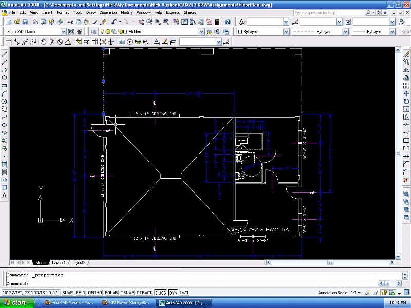

I am working on a floorplan and I'm having difficulties with LTScale.
The attached drawing has an overall ltscale of 20. The hidden lines along the top of the drawing have a ltscale of 5.5 which I set using the properties box.
It took me a while to get the center(magenta) and hidden lines to look right but I finally got it using these settings.
The problem is when I switch to paperspace the lineweights are all screwed up. They all appear solid.
Any help and suggestions are welcome.

Check your PSLTSCALE setting. That way the lineweights will stay the same in paper and model space.
It's set to one. Is this correct?
Thanks a lot. This worked great!
