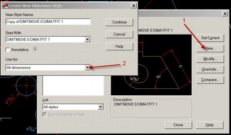

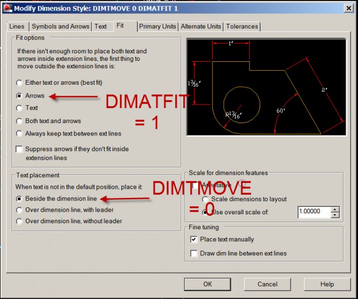

rkent Posted June 7, 2011 Posted June 7, 2011 (edited) You should simply use dimension command, radius or diameter tools. Add a child style to your current dimstyle for Radial and one for Diameter. Set the DIMTMOVE, DIMATFIT, AND DIMTIH as shown in the attachment. DIMTOH set to off. Edited June 7, 2011 by rkent added dimtoh Quote
rkent Posted June 7, 2011 Posted June 7, 2011 (edited) To create a child style for a dimstyle, start the dimstyle manager, pick New (1), then go to the drop down list (2) and pick radius, proceed from there. You will see a tree structure with your main dimstyle name and then the child styles below that have their own overrides for the radial dims, etc. Repeat the steps for diameter dims. Edited June 7, 2011 by rkent Quote
