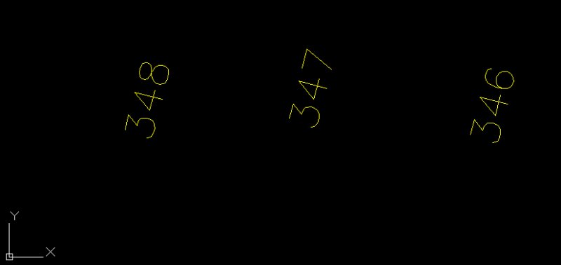

rajrehman Posted July 10, 2011 Posted July 10, 2011 i want to move lot of text in drawings but text can't roted to 0 rotation here i attached some text plese give me some solution from it Drawing3.dwg Quote
irneb Posted July 10, 2011 Posted July 10, 2011 Firstly those text are drawn at some ucs, so setting their rotation to 0 turns them like this: Secondly, I can select them fine - all at once. Then open the Properties palette (Ctrl+1) and modify the rotation. So the setting (if it is something like that) is not one which is saved in the DWG. Here's my settings (those I can think of which could affect selecting multiple objects): PickAdd = 2 PickBox = 4 PickFirst = 1 PickDrag = 0 PickAuto = 1 PickStyle = 0 GripObjLimit = 100 GripTips = 1 GripMultiFunctional = 3 Grips = 2 RibbonContextSelect = 1 GripBlock = 0 DblClkEdit = ON/1 SelectionAnnoDisplay = 1 SelectionArea = 1 SelectionAreaOpacity = 25 SelectionCycling = 0 SelectionPreview = 3 SelectSimilarMode = 130 SubObjSelectionMode = 0 That's as exhaustive as I can think of. Some of those are probably not available in 2007. Quote
