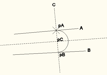

Anyway, in case anyone is interested, these are the steps I found to make an arc tangent to 2 lines when only one point on a line is given.
Problem:
Given, line A, B and point pA, now draw an arc tangent to both lines tangent at point pA – without resizing or panning the drawing area.
Solution:
#1 – create perpendicular line at pA. quickest way I found (someone pointed it out to me, I didn’t find it myself) is to use the ROTATE / COPY command.
Select ROTATE, select line A, set base point to pA, select Copy, rotate 90 – done.
#2 – find the bisecting angle between the 2 lines, here I use the idea given by eldon, but instead of drawing a circle I use a construction line XLINE and chose Bisect. At the ‘specify angle vertex point’, shift –rightclick and selected “apparent intersect” from the OSNAP menu, select both lines. At the ‘angle start point, select one of the lines (anywhere ON the line), ‘specify angle endpoint’, select second line. Now you have a construction line dividing the angle between the 2 lines.
#3 – now draw the arc, using the intersection point at pC as center, then click on pB and finally pA.
Can anyone come up with a quicker way (less clicks and commands) ?

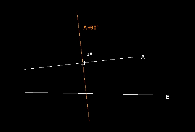

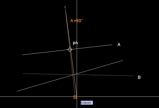

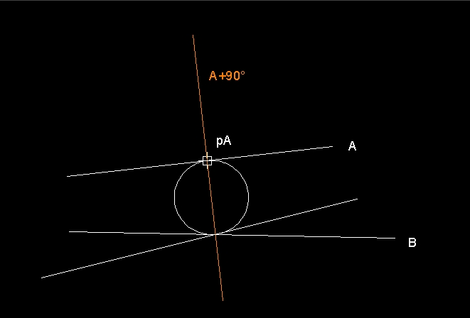

Here’s different method. I wouldn’t say, necessarily, that it’s quicker or requires fewer clicks – or, for that matter, that it is completely different. It may be of some interest however:
1. Construct perpendicular “A” as previously described.
2. Mirror “B” about “A+ 90"
3. Circle – with 3pt option and running Tangent osnap. Pick A, B, mirrored B
4. Delete construction geometry and Trim circle to Arc
Good one, I would never have thought of that solution. Just shows that the same problem can be solved in many ways.

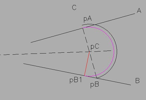

Excuse me, but your geometry does not fit.
In your solution, the lines are drawn nearly parallel, but if you exaggerate the dividing angle, you will see what you have drawn is not exact. :(
Comments on solution
#1. I drew the perpendicular bisector using polar, and drawing a line at right angles to A. When this line crosses B the angle is not a right angle, therefore pB is not a tangent point! :(
#2. I like the XLINE. It was not available when I started, but I am still learning. :D
#3. If you draw an arc centred on pC and starting on pB, it does not pass through pA. :cry:
#4. However, if you draw a line from pC perpendicular to B, you arrive at the proper position for pB1. :D
One comment about drawing arcs. There are so many different set-ups, and you have to remember that it draws in an anticlockwise direction, that I find it easier to draw a circle and trim.
In your problem, you could have drawn an arc (Centre, Start, Angle), centred on pC, starting on pA, with an angle of -180 (to make it draw the right way). Then extend that arc to line B.

You are absolutely right, of course pB must be perpendicular to B for the tangent point as you have shown in pB1. - I don't know what I was (or wasn't) thinking :oops::oops:
