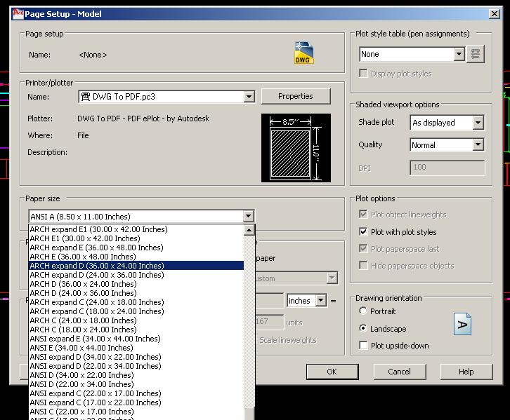

How do you change your paper size? I'm not given the option in the drop down box:
Thanks!

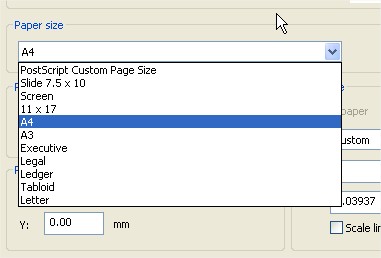

Paper size is plotter dependent in most cases. Sometimes you need to select properties and add paper sizes to the plotter.
It may do no good to try to add a paper size larger than what the plotter/printer can physically support.
Customer asks that I remake my drawings to fit on 36 x 24 so that he can submit them to the architect. I tell him that we print at 17 x 11s here at the office because that's the biggest paper we can print on. I said that whoever he uses to print my PDFs can just scale them to fit but the scale factor in my drawings will be incorrect (which is the only down-side). He still wants me to change my drawings for 36 x 24. Help!
what plotter are you selecting? If I select DWG To PDF.pc3 as my plotter I can select the sizes you require.
That did it, dbroada. Thanks!
Got it, Jack. Thank you!
