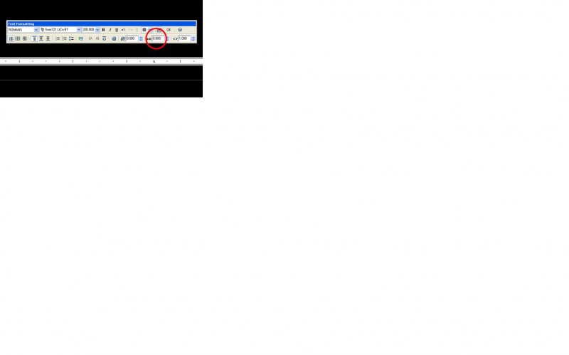

nextvkin Posted June 1, 2011 Posted June 1, 2011 Ohio gossamers, TFU, , is this what you're looking for? Quote
tennis4you Posted June 1, 2011 Author Posted June 1, 2011 Kinda. But is there a way to have it defaulted at .89x? You can also changed the text spacing on the "paragraph" button on that same tool bar. But I do not want to have to change every multi-line piece of text I ever place, that would be a huge pain. Quote

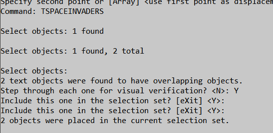

SLW210 Posted June 1, 2011 Posted June 1, 2011 TSPACEFAC is the sysvar, not saved anywhere, you could have it in a lisp file to set that each time. TIL: there is a command in 2012 called TSPACEINVADERS It is an Express Tool, undocumented. I detects text with overlapping objects. Been around awhile. Quote
Dana W Posted June 1, 2011 Posted June 1, 2011 It is an Express Tool, undocumented. I detects text with overlapping objects. Been around awhile.OK, I thought you were kidding around. No point in me even trying it. LT don't got no express tools. There is no Autocomplete either. Ya' gets what ya pays for. Quote
