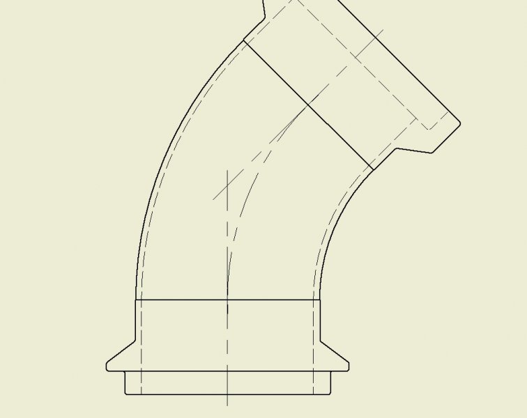

is there a good way to "snap" connect centerlines in a drawing, or a way to trim or extend them to the next centerline. There doesn't seem to be a good quick way in Inventor 2011 - weird - am I missing something
my scenario is - I have a 90 degree elbow with some straight tangent ends- to which I've inserted centerlines to the elbow and thru the straight sections. I need to dimension from the center point, on the backside of the 90deg arc, to the face of the straight end. I can do that, but I have to use "intersect" for the centerlines instead of just having them "intersected" already :?

do you have a screen shot to clarify what you need a little clearer?
you can see the 2 center lines that need to snap at a certain point
If you click on the center line you can drag the endpoints.
But aren't center lines supposed to cross?
there are some applications where it is more for looks than anything else. The point is, you still should be able to access the centerlines just like any other line.
