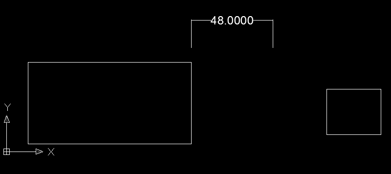

Yes you can. select the object you want to move, then select the base point. Using object snap tracking you can specify 48" from the current snap point without actually selecting it as such:
